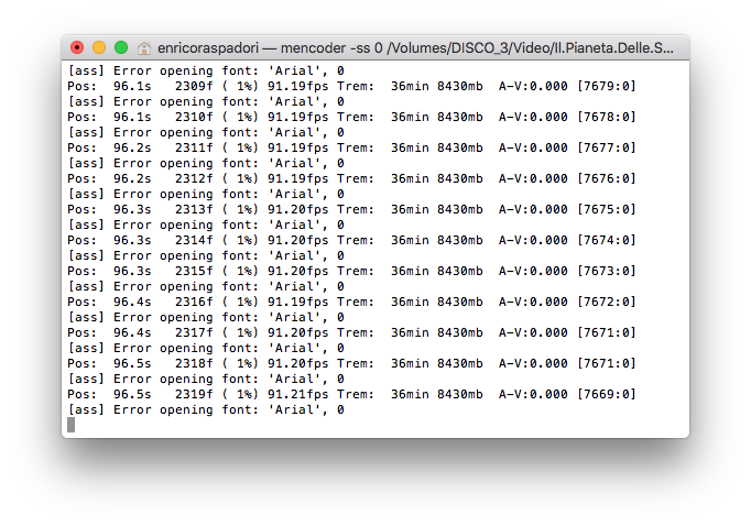

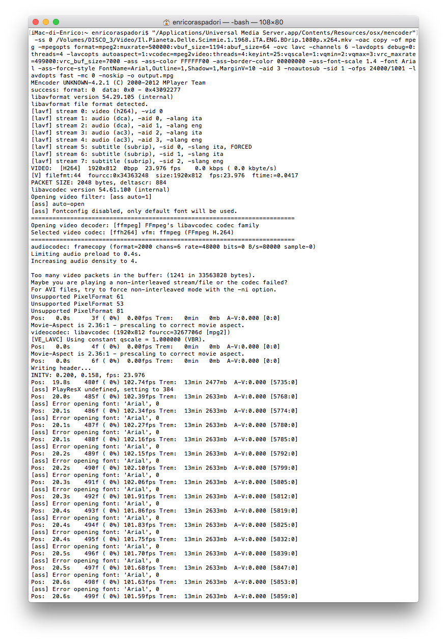

Re: Can't transcode video file with subtitles
thanks for your great help.
I can't use Mencoder in this testing version because of an unknown error the engine is not available.
I have an iMac with OsX 10.13.6.
I've tried to play a trancoded subtitled file with Mencoder.
Now I can correctly play file but subtitles are not working.
I attach the results of a failed subtitles encoding with Mencoder with normal UMS. Media infos are:
Thanks, I can see that we are sending MEncoder the following command:
I will try running that on my mac and see what happens
"/Applications/Universal Media Server.app/Contents/Resources/osx/mencoder" -ss 0 video.mkv -msglevel statusline=2 -oac copy -of mpeg -mpegopts format=mpeg2:muxrate=500000:vbuf_size=1194:abuf_size=64 -ovc lavc -channels 6 -lavdopts debug=0:threads=4 -lavcopts autoaspect=1:vcodec=mpeg2video:threads=4:keyint=25:vqscale=1:vqmin=2:vqmax=3:vrc_maxrate=499000:vrc_buf_size=7000 -ass -ass-color FFFFFF00 -ass-border-color 00000000 -ass-font-scale 1.4 -font Arial -ass-force-style FontName=Arial,Outline=1,Shadow=1,MarginV=10 -aid 3 -noautosub -sid 1 -ofps 24000/1001 -lavdopts fast -mc 0 -noskip -o - -really-quiet -msglevel statusline=2
The command works ok for me on another file. Can you please run this in your Terminal:
and tell me what it responds with?
"/Applications/Universal Media Server.app/Contents/Resources/osx/mencoder" -ss 0 /Volumes/DISCO_3/Video/Il.Pianeta.Delle.Scimmie.1.1968.iTA.ENG.BDrip.1080p.x264.mkv -oac copy -of mpeg -mpegopts format=mpeg2:muxrate=500000:vbuf_size=1194:abuf_size=64 -ovc lavc -channels 6 -lavdopts debug=0:threads=4 -lavcopts autoaspect=1:vcodec=mpeg2video:threads=4:keyint=25:vqscale=1:vqmin=2:vqmax=3:vrc_maxrate=499000:vrc_buf_size=7000 -ass -ass-color FFFFFF00 -ass-border-color 00000000 -ass-font-scale 1.4 -font Arial -ass-force-style FontName=Arial,Outline=1,Shadow=1,MarginV=10 -aid 3 -noautosub -sid 1 -ofps 24000/1001 -lavdopts fast -mc 0 -noskip -o output.mpg
thanks for your precious help.
I think it could be an error about fonts.
I attach you the terminal screenshot. Thanks
I also attach the initial verbose print.
