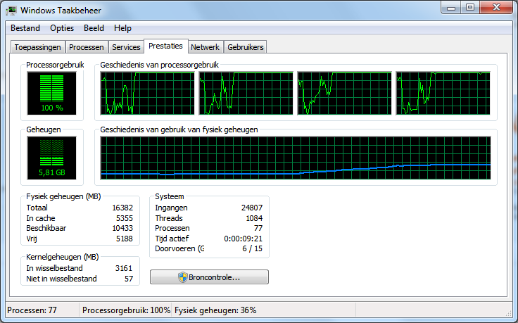

I have attached the log file and made a print screen of the Task Manager.
I was trying (in this case) "Django Unchained (2012).mkv"
btw,.. This is with subtitles enabled.

- Task Manager
- UMS.png (43.49 KiB) Viewed 12984 times

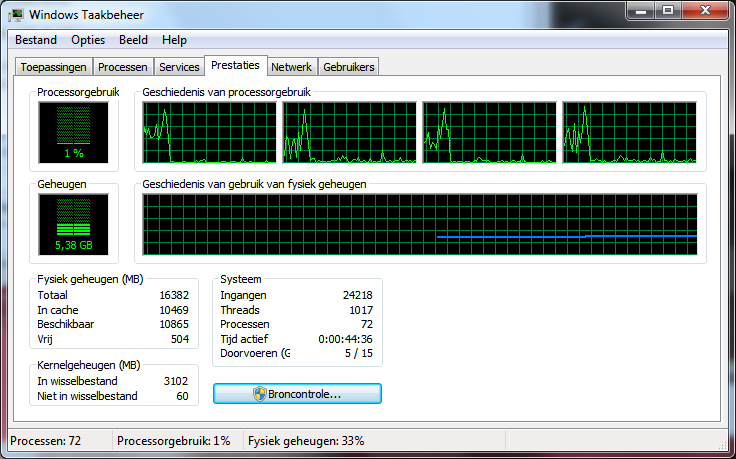

This one is with the subtitles disabled (same movie though)
(2 x VGA in SLI with CoreAVC)
- Task Manager
- UMS.png (59.07 KiB) Viewed 12981 times

It does for all of your files or Django only? When subs are needed, 80-100% CPU usage is normal.I have a problem with the subtitles within the MKV. It always worked like a charm, but, I think this problem started after the latest PS3 update a couple of weeks ago.
In log I spotted MEncoder creates separate video stream with subs. It also creates modded audio DTS stream so it can be played on PS3. These two streams are muxed together with tsMuxeR.
I can't say which one is problematic, but UMS logged null input stream:
Try to untick Keep DTS track in AUDIO settings in GUI so audio will be reencoded to AC3 so if problematic stream is audio, it should play. If video, file will be unplayable. Anyway it seems MEncoder/tsMuxeR has problem with this file.TRACE 2013-04-29 10:56:40.028 [New I/O worker #3] External input stream instance is null... sounds not good, waiting 500ms
