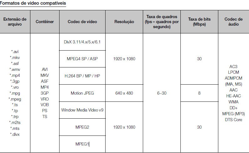

Using 5.1.1 + clean install + no changes in order of transcoder / video file engines.
Now, 90% of files that this tv recognizes, don't have time search or permit back / forward in time, appears 519 mil minutes (possible because transcoding in real time).
But, if change primary VFE on Transcoding FFMPEG to another, this problem don't occur, but some files don't play or recognizes (in tv, so much files is "not supported now, or not supported by this device), on olders versions this happens whit some MKV's (WMV9). All audio (mp3 / mp4 / flac) works fine.
This tv is similar and share the same settings in manual (and supported files) of PS490 / PL 491 séries (Global), and PS 550 séries (EU), maybe possible good to another users that have any of this TV's, reply too ;
And have any way possible to have a config especific that forces AVC-HL'5 10/8bits MKV@Mp4 to play / transcoding (not supported) in this TV? Much, much of my files with this don't play
Thanks for all (and sorry for my english / not main language).
