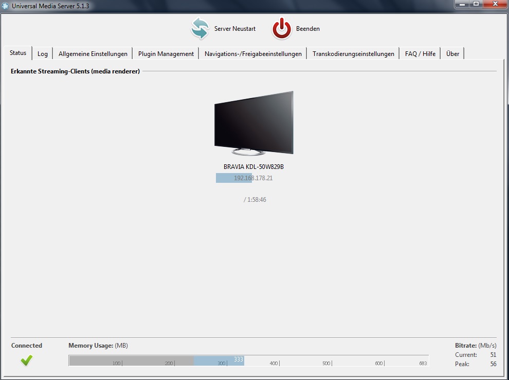

Hello people,
I've recently gotten myself a Sony Bravia KDL-50W829B TV and started messing with DLNA. First I've tried PS3 Media Server as it's the most known one and it worked fine except for files with subtitles. Anyway, through some googling I came up with Universal Media Server and installed it. It was working so much better with the subtitles files and also seems to be overall better and more stable.
The one thing I can't get to work (and it was working with PS3 Media Server) are files with dts tracks.
So far I've tried:
  • * Remuxing
    * Removing the DTS (File plays normally then)
    * Enabling "Keep DTS tracks"
    * Enabling "Encoded audio passthrough for AC-3 and DTS"
    * Disabling "Automatic resampling"
The file "pretends" to play on the TV but it gets stuck at 0:00:00 and never actually starts. When I pause and resume, the time is running but no video is visible and no audio is playing. I've also tried different files (much smaller ones), as soon as a DTS is involved it won't play.
Thanks in advance for the help.
