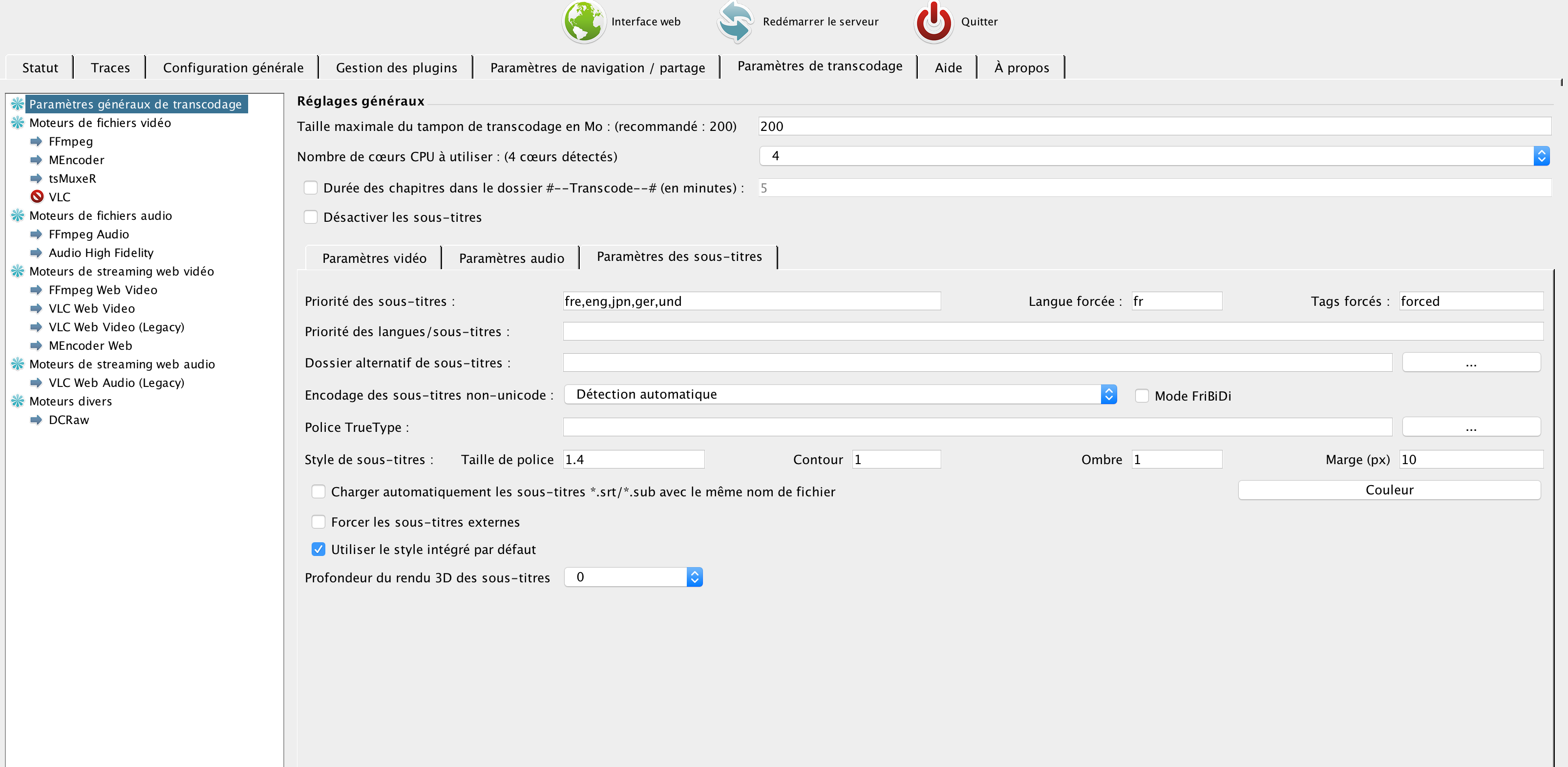

Here is a new log file in which I tried to play two mkv files with subs from my movie folder and from the transcode folder as you suggested. You can also find a screenshot of my UMS set-up (in French).

Re: No subtitle with High Sierra
I know nothing about macOS, but as your OS seem to use CoreText for font renderering, so that could be the source of your issue.
Try to do the following, and try again:
Go in the "Transcoding Settings" tab, select FFmpeg video engine on the left panel, and then select "Use font settings..."
After that, from the same panel, select "Common transcode settings" and then click on the "Subtitles settings" tab. From there, in "Specify TrueTypeFont" select the font you like and restart before a new test.
Hoping that helped you.
Well done Sami32, I just tried what you wrote and it seems to be working !
