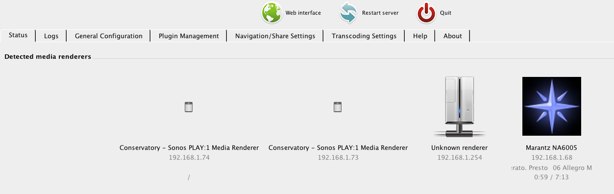

I was holding back on power-cycling the BT SmartHub since I was using it elsewhere - anyhow, 10mins ago I unplugged the bugger and let it rest for 2mins. Connected the Hub back up - did the same for the Marantz - and hey presto, what do-ya-know the Marantz popped up on UMS (see screen grab above) and I am currently listening to a Flac file via the Mac/UMS/Router/Marantz - LOUD & CLEAR!

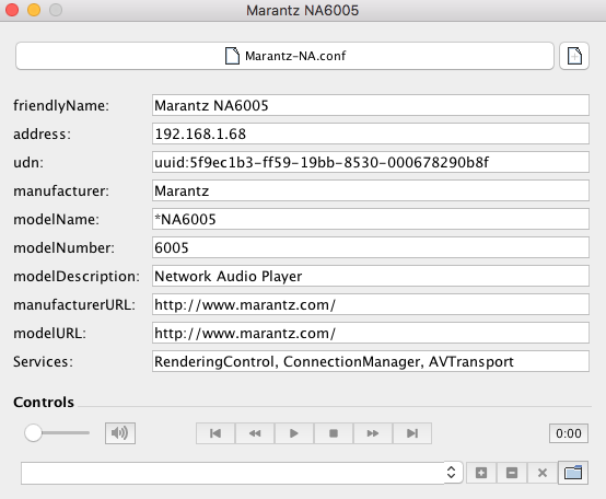

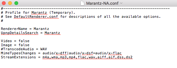

I am uncertain how to find the "aac' in "Supported Lines".
I have opened the Marantz config with TextEdit (Mac) which gives me this:-
Here is the Marantz info from the UMS STATUS window :-
I somehow don't think I am looking in the right Folder (?)
Any suggestions?
Any suggestions?
Cheers

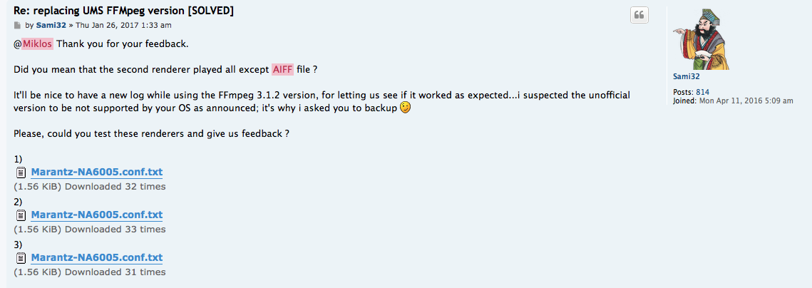

You're in the right file, but this file is very inaccurate and outdated. @Sami32 already made some renderer configurations for you to try in this thread: viewtopic.php?f=11&t=9151&p=29511&hilit ... Mac#p29525
You should try these and report back to him.

I didn't know if any of the suggestions from Sami32 would still work with my later set-up - anyhow, I carried out a FFmpeg upgrade (I'm now using the latest directly from the FFmpeg site for Mac - 3.4.2) and patiently worked my way though all the suggested (and kindly provided) Marantz configs that Sami32 prepared last year. It is difficult to identify one from another (but for anyone else who might be following this and also seeking similar help) the top one (No1) from the 3 posted on 26th Jan 2017 works the best of all.
