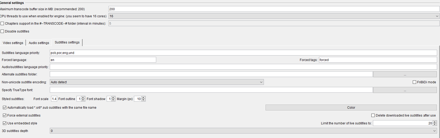

New bug: UMS won't load and stream 3d video w/ external subtitles. Example below:
My settings:
last log lines from debug.log:
