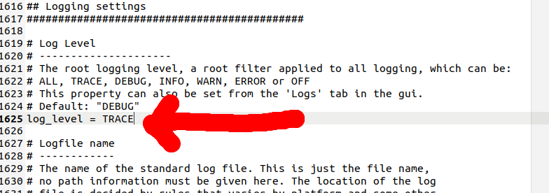

As you can see from the attached screenshot, UMS.conf already has Log_Level = TRACE:
The above is a screenshot of /home/main19/Applications/UniversalMediaServer/UMS/UMS.conf
Strangely, I see two UMS.conf files in my home directory, both of which are attached to this post:
1) UMS.conf located in the directory into which I extracted the file I downloaded for version 10.17 of UMS, that directory is /home/main19/Applications/UniversalMediaServer/UMS That file is attached to this post under the filename of UMSconf_in_UMS_extraction_location.conf
2) UMS.conf located in this directory: /home/main19/.config/UMS That file is attached to this post under the filename of UMSconf_in_.config_location.conf
Do you think having these two files is what is causing the problem????? I have no idea how or why there are two files with the name of UMS.conf on my system.

I missed that you said you were using Linux
The UMS.conf file in /home/main19/.config/UMS is the one used for the settings so that is the one you need to edit to add Log_Level = TRACE on to the end.
The one in the UMS directory is used on first run to set up the conf for that user on the computer and has each setting documented while the other one is stripped down to bare minimum to run in each users config.
I have very little experience with Linux but hopefully I can spot something in the trace logs that can narrow down your problem.
