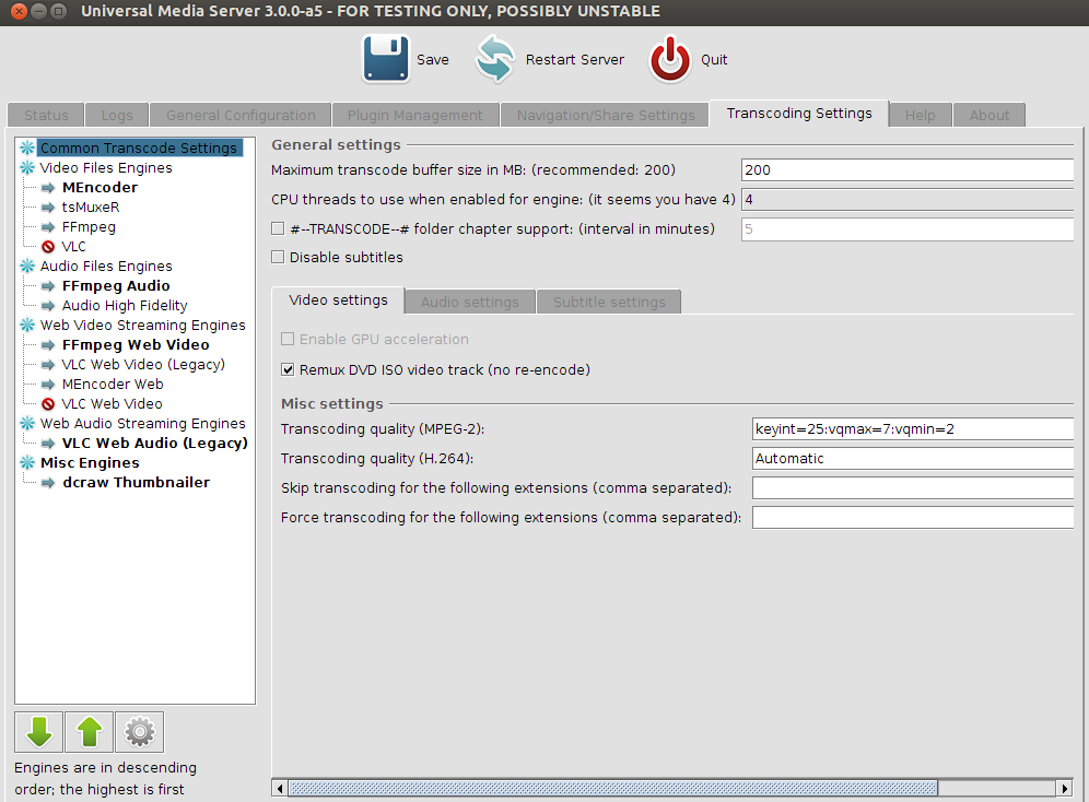

Post by sfunk1x »
GPU Acceleration is greyed out, as you can see in this screenshot. This is true for 2.6.5 as well as 3.0a5.
Screenshot of GPU acceleration greyed out
Optimus_prime
Posts: 678
Location: Sydney, Australia
Re: MKV stuttering with stable and 3.0a5
Post by Optimus_prime »
The GPU acceleration is only a feature of Windows UMS i believe. I could be wrong but someone can correct me.
