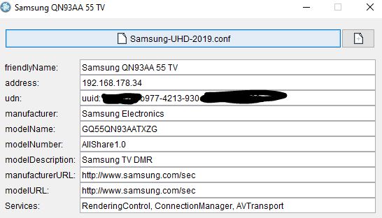

Edit: I've just noticed, that when I click on the living room TV, it's showing as Samsung-UHD-2019.conf even though "Samsung Q6 Series" and Force default renderer are enabled. Is this correct?

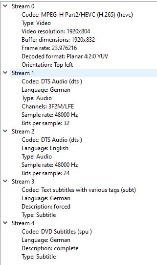

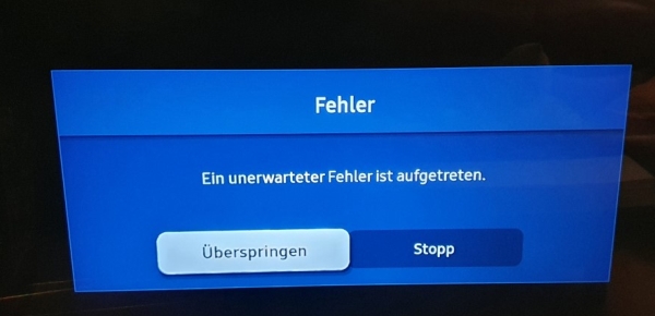

at my new Samsung GQ55QN93A (same like xxQN90A) the same error occurred on transoding DTS files to the Samsung TV.
Manual: https://org.downloadcenter.samsung.com/ ... 0910.0.pdf
I use the SubJunks config file from this thread Sep 03, 2021 3:59. The technical details looks same at the manual.
I browse to the #transcode folder, starts the file, the error occurres, when i play the file without transcoding... there is no sound.
Thank you for your support und sorry for my bumpy english...

Re: Another Samsung thread "An error occurred"
Thanks for the logs. I have attached a new config for you to try please:
I can see we are sending:
and then we start transcoding with:
they seem to communicate about the file but I guess that conversation doesn't go how the TV expects. We send:
and it sends:

Hello SubJunk
thanks for your answer.
I downloaded and installed your new Config-File as described.
But no dts-files (try >10 different ) are working, they show the same error.
Log and some pictures attached.
Notice for analysis:
The file directory has changed, about a rebuild of the PC.
Thats also the reason for the long time to my answer...
