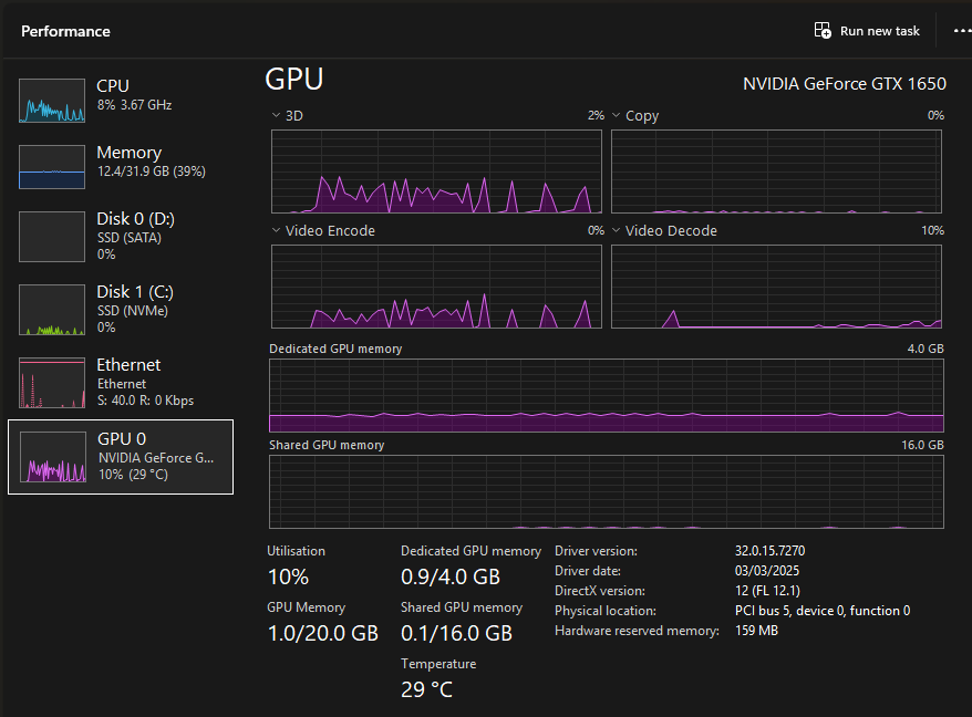

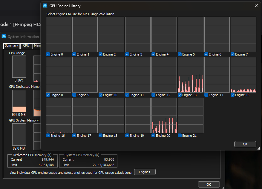

You could also do logs while playing in the web player as this will transcode everything to one standard format that it can play well using HLS.
This may still use a lot of CPU, at least initially, as it has to split the video into tiny chunks to be transcoded separately and this will need more CPU to set this up.
GPU usage may actually not show much change as it will only be using a small part of the GPU and because of the start stop nature of HLS there will only be spikes of activity so the average usage will be very low.
This is what it looks like playing for me with a GTX 1650 on windows according to Task Manager and Process Explorer
Starting "C:\Program Files\Universal Media Server\bin\ffmpeg.exe" -y -loglevel info -t 6.0 -sn -i C:\Users\Mik\Videos\video.mkv -sn -dn -copyts -c:v h264_nvenc -keyint_min 25 -profile:v high -level 41 -pix_fmt yuv420p -c:a aac -ac 6 -ab 320000 -f mpegts -skip_estimate_duration_from_pts 1 -use_wallclock_as_timestamps 1 -movflags frag_keyframe \\.\pipe\ffmpeghlsvideo_67_1742047834493

Screenshot 2025-03-17 184929.png (58.01 KiB) Viewed 4155 times

Screenshot 2025-03-17 184758.png (55.99 KiB) Viewed 4155 times
Also try with setting to use the FFmpeg version installed by UMS as this has the HLS feature enabled along with some others it might need.
This should also have the Nvidia headers included in the build.
