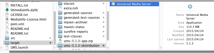

michaelt
Posts: 155
Joined: Tue Feb 03, 2015 11:18 am
Location: lost in the depths of my mind
Re: Java 8 Prompts for Incoming Network Connections
Post by michaelt »
… and in the light of a new day things are brighter.
Had to reboot to recover the inactive memory, then NB indicated some 14 updates, did them, clicked Build and success:
main:
    [mkdir] Created dir: /Users/umsmkv/UMS_J8/universalmediaserver/target/ums-5.1.3-distribution
Executed tasks

BUILD SUCCESS
Total time: 2:40.154s
Finished at: Fri Apr 24 10:15:44 EDT 2015
Final Memory: 47M/1084M
… but it won't launch.
I don't understand why it just started to work.
Better but not there.

Optimus_prime wrote:NB is only so you can build your own versions which java 6 should be fine
I am Java 8 so as to also track down the access permission and port issues.
Optimus_prime wrote:are you launching UMS form the .dmg it makes for you?
No - I launched directly from:
Screen Shot 2015-04-26 at 9.29.45 AM.png (45.41 KiB) Viewed 12825 times
I did not see a way in NB to build the package.
I tried: "mvn package -P osx" but no "*.dmg" anywhere in my user tree.
Also I loaded the NB-Java8 package directly from Oracle.
