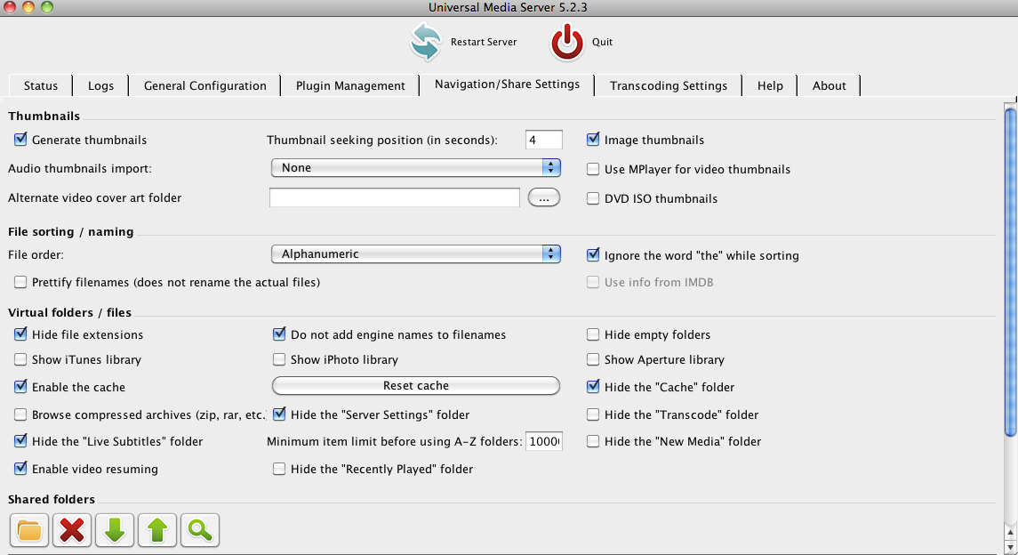

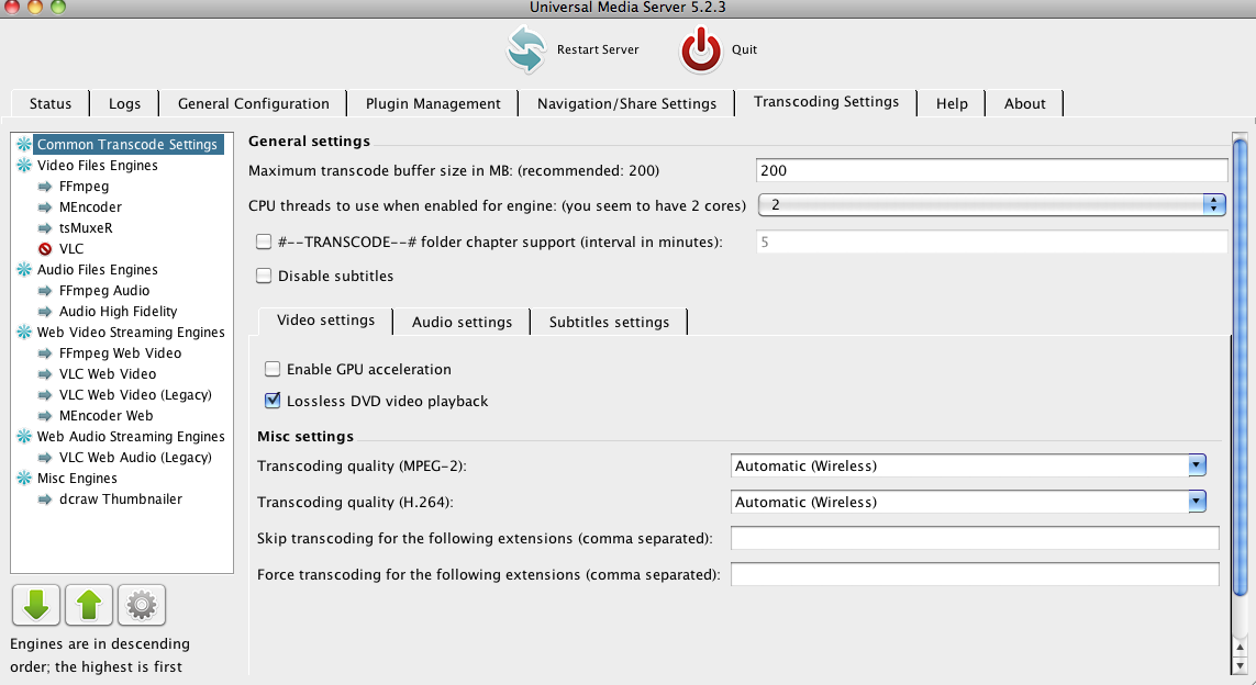

I can't find an option to enter NO ENCODING as suggested - check out attached screen grabs. Am I looking in the right place?

From looking at your screenshots the transcode folder should be visible on your renderer (when browsing your files).

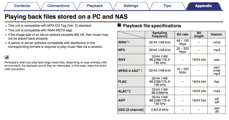

Attached is the supported files page from the Marantz handbook - showing aiff/aif as supported (but I already know this since they playback from i-Pod/USB sticks direct into the Marantz). It just seems that AIFF for some reason are not being allowed (FILE FORMAT ERROR) - mp3, WAV and FLAC all come through without any additional settings.......

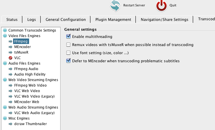

Attached is the UMS Window that I suppose I use to configure this - but can't seem how to achieve it - set FFMEG as first choice video engine ....

OK, it's fine, FFMpeg is already your first engine choice, so you don't need to do anything.
