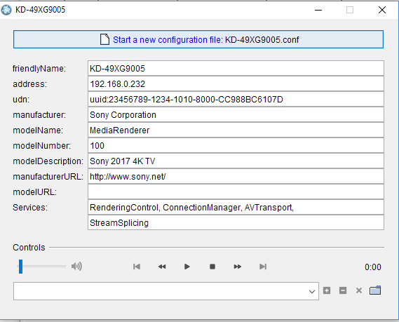

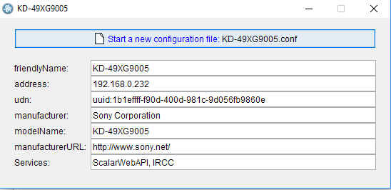

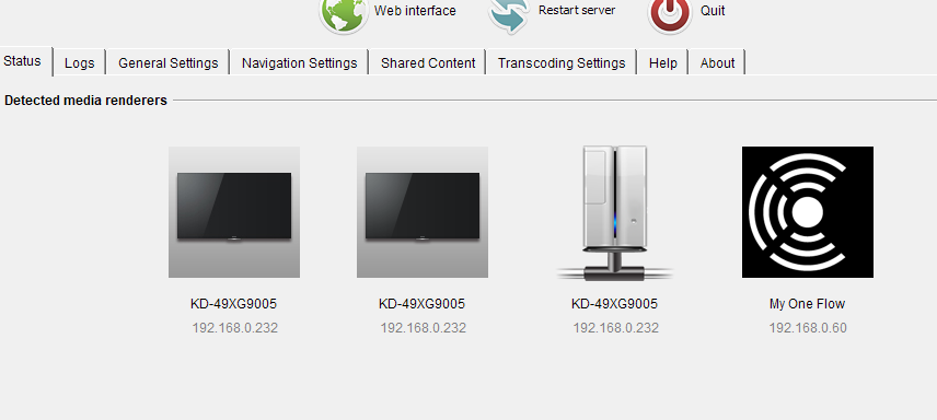

This file is for the Sony KD-49XG9005 (2019 model, in 49" only).
For some reason, 3 renderers are appearing.. (attached). Along with this error:
User-Agent: UPnP/1.0
X-AV-Physical-Unit-Info: pa="BRAVIA KD-49XG9005";
X-AV-Client-Info: av=5.0; cn="Sony Corporation"; mn="BRAVIA KD-49XG9005"; mv="3.0";
14:53:10 INFO Media renderer was not recognized. Possible identifying HTTP headers:
Thanks for your support. (zip in next post)

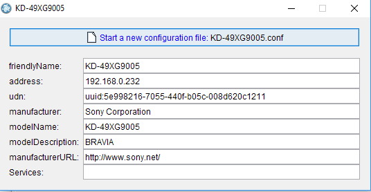

Re: Help us improve support for your devices
Sony KD-49XG9005 log;
- (107.55 KiB) Downloaded 1223 times
- ums_KD-49XG9005_4.PNG (43.89 KiB) Viewed 20809 times
