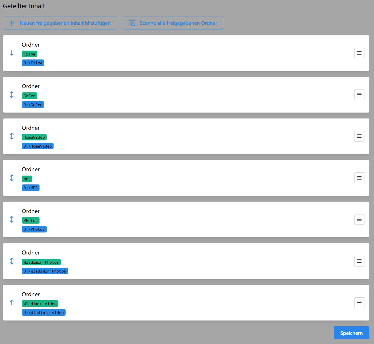

@yawa It is better to only share the media folders on your drives and not the whole drive itself if there are other things on it as it will slow down scanning.
It would be better to set up seperate Image, Video, and Music folders and will be quicker to access on your device while browsing.
No need to edit the SHARED.conf youself though, it is easier to do with the web UI. setting "active: false" means this folder will be disabled and "monitored: false" means UMS will not track played status or when new files are added to this folder.
Normally you would want these to be true but disabling all but a folder with a small number of files will be good for testing.
Turning off thumbnails will help with resources while scanning but once they are generated they will be stored in the database so should not have an impact after that.
Maybe becasue of the number of files in your library the database is too large. This can also somtimes happen after an update if the database is not upgraded properly and can bloat the database.
You could try uninstalling UMS and do a clean install of the latest version with all the settings at default and only add a few shared folders including some of the problem ones that have showed as errors I posted above.
Also edit UMS.conf while it is not running to add
log_level = TRACE
