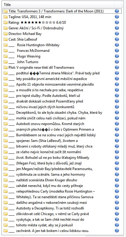

Re: MovieInfo
Here the difference (ignore bad chars... it is problem of eezUPnP, in XBMC chars are ok)
First one shows ČSFD.CZ in title name what should be filtered. And from "Director" none is parsed correctly so not showed at all?
- CSFD -Bad
- csfd-bad.png (6.19 KiB) Viewed 22035 times
- CSFD - OK
- csfd-ok.png (37.46 KiB) Viewed 22035 times
