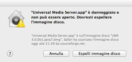

If you can explain it to me, I can help, I have a degree in CS, so it should not be so hard!
EDIT:
It tells me that the application is broken/damaged and should be put in the bin.
EDIT:

I'll redo it and repost it. Something strange going on there.
Edit: I just checked it and it looks fine for me, anyone else having this issue?

Nope.
Same error. In the screenshot (Italian, sorry) the detail.
Any suggestion?
Any suggestion?
- I tried running it from the DMG and from Application folder, the issue is the same.
- screen.png (40.47 KiB) Viewed 15287 times
- Optimus_prime
- Posts: 678
- Location: Sydney, Australia
Re: [Testers Required] UMS Running on Java 7
I will redo it and post it again for you mate. Not sure why thats happening. Strange indeed

Nope.
I tried both with Safari 6.0.5 (85536.30.1) and Firefox 22 on OSX 10.8.4
Could you try to zip it, maybe something during download bothers my browsers...
Sure can cyberbooster, as soon as i get back from work i will do it for you
