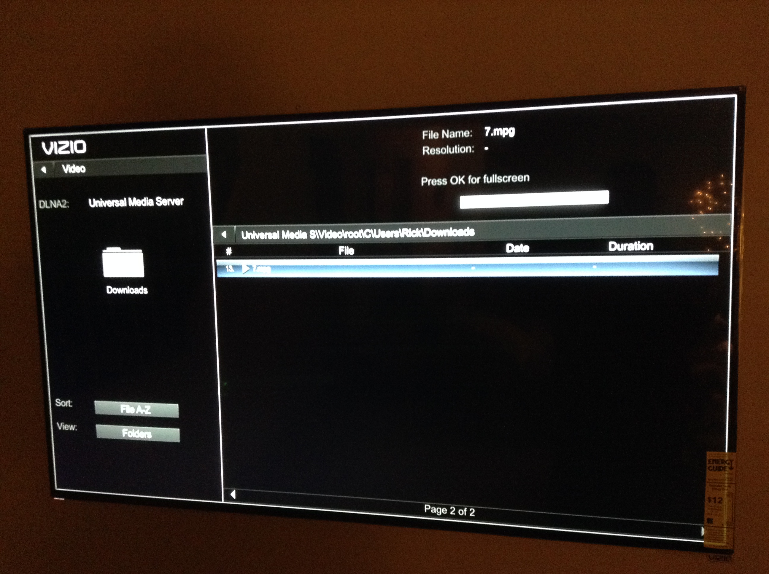

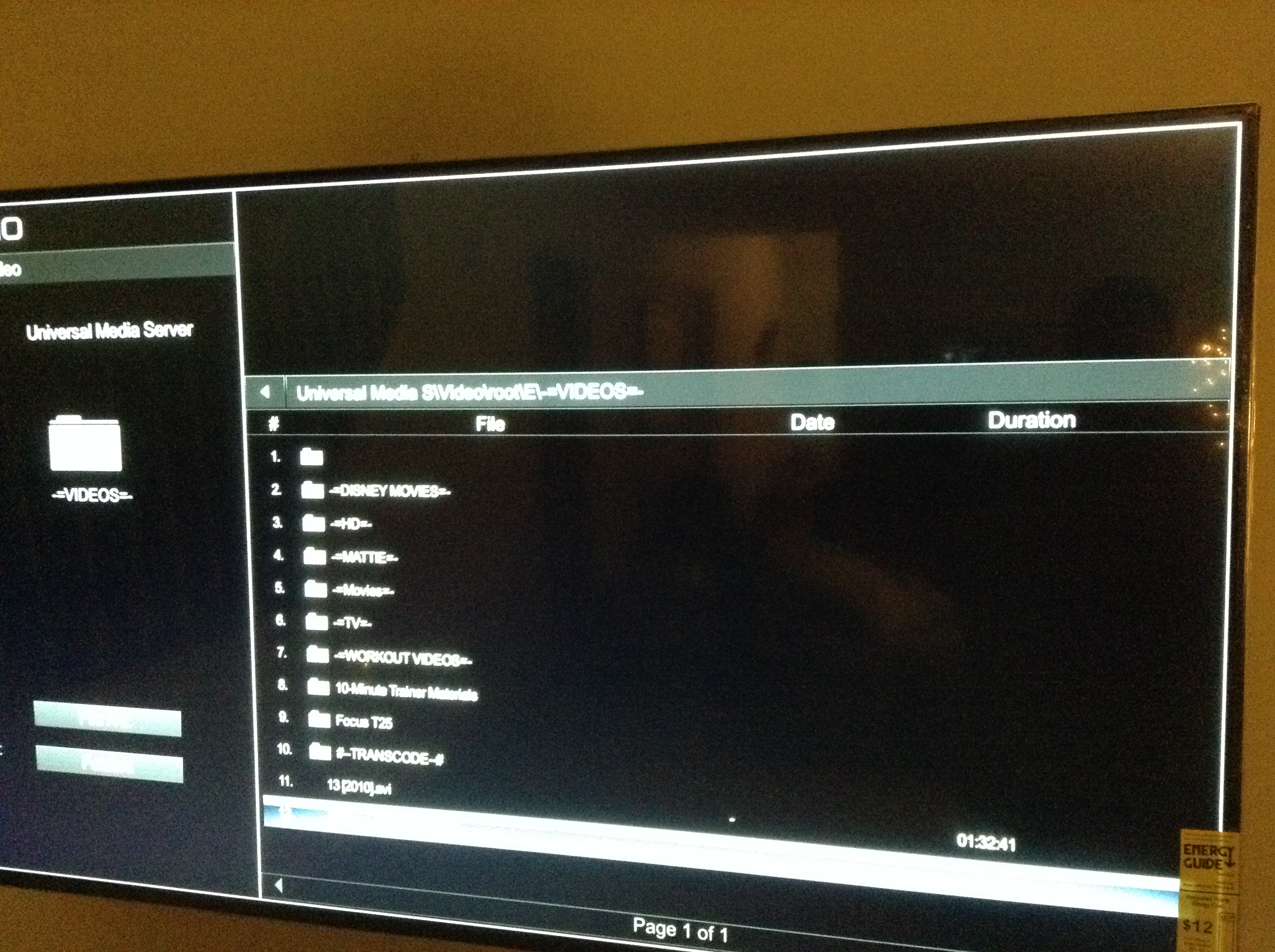

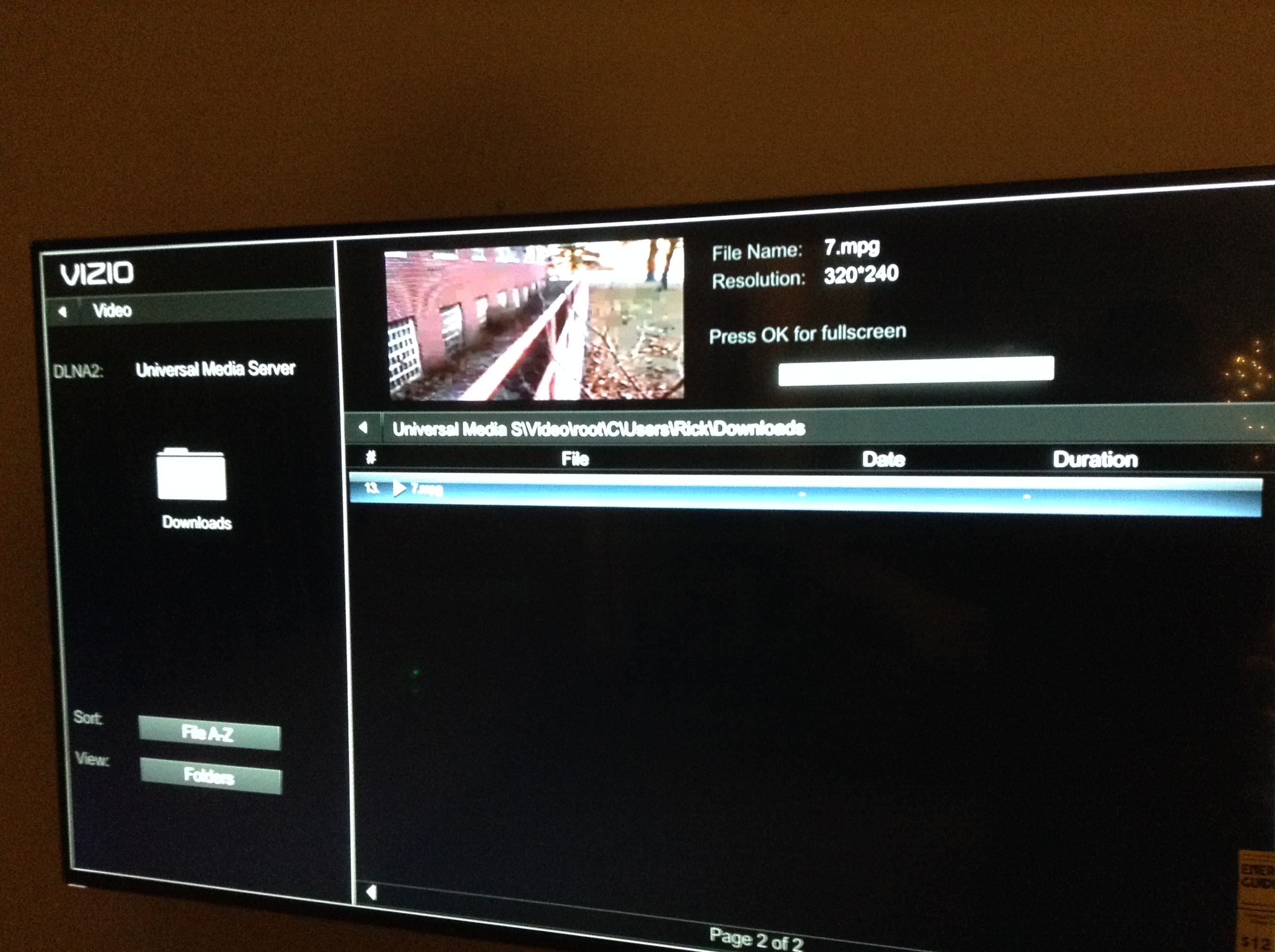

The 3 attachments are to show what it does on the TV.
Photo1.jpg = When it "starts" playing but hasn't played yet. This is normally after a few minutes.
Photo2.jpg = When it's actually playing.
Photo3.jpg = When I press play, and it just sits there waiting before it does what Photo1.jpg shows.
