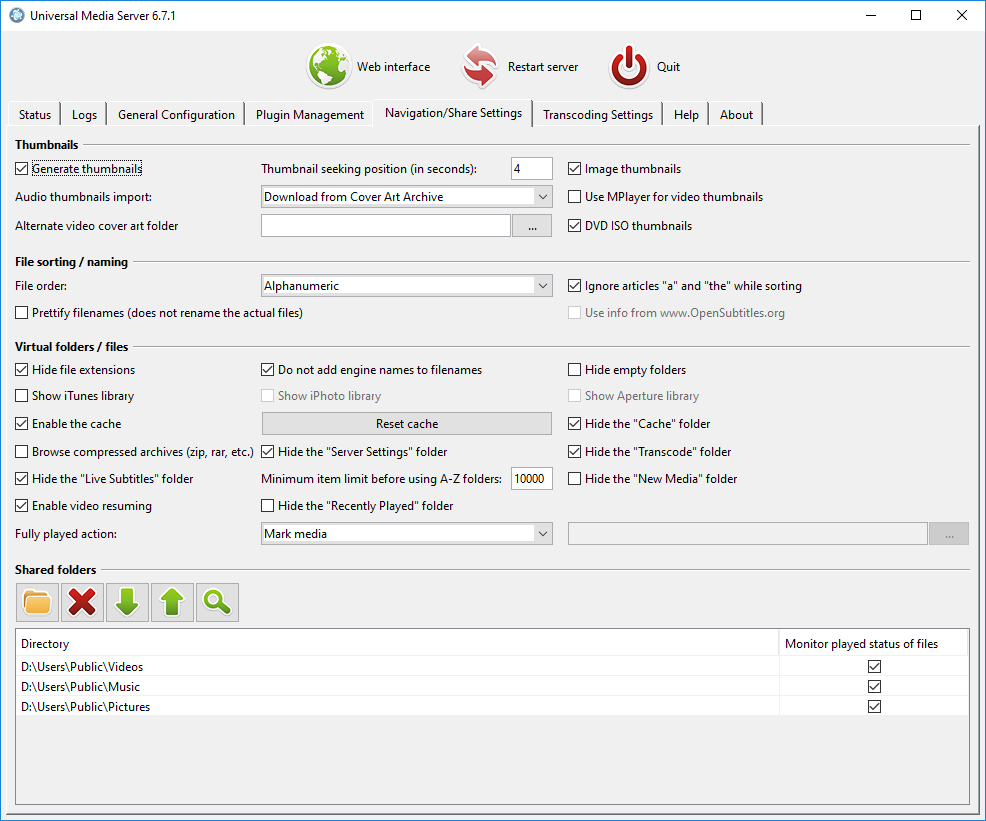

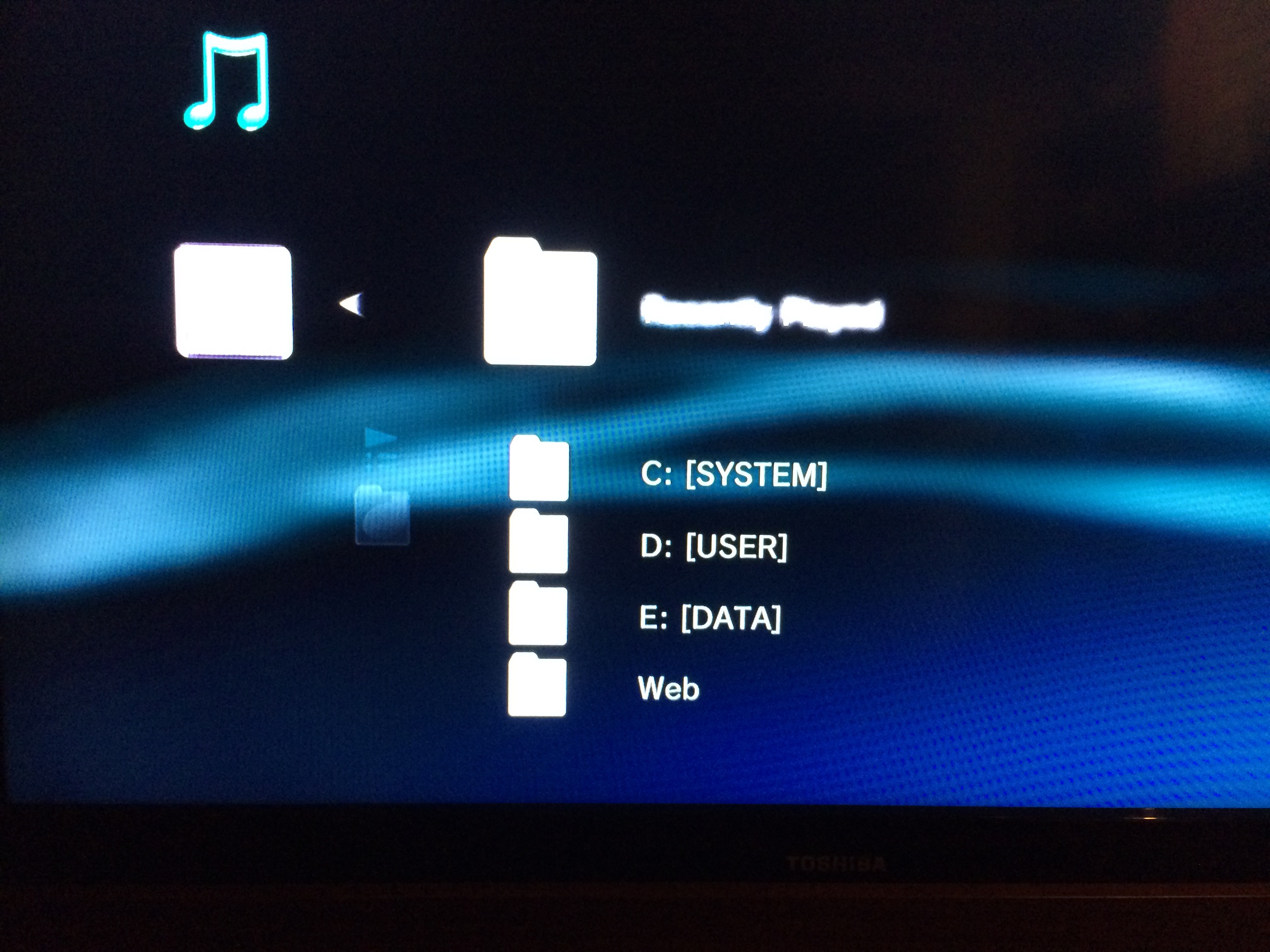

Attached are
The ums_dbg.zip file
A screencap of the config tab
A pic of the PS3 screen.
- IMG_3536.JPG (1002.15 KiB) Viewed 11728 times
- Navigation-n-Share_Settings.png (52.35 KiB) Viewed 11728 times
