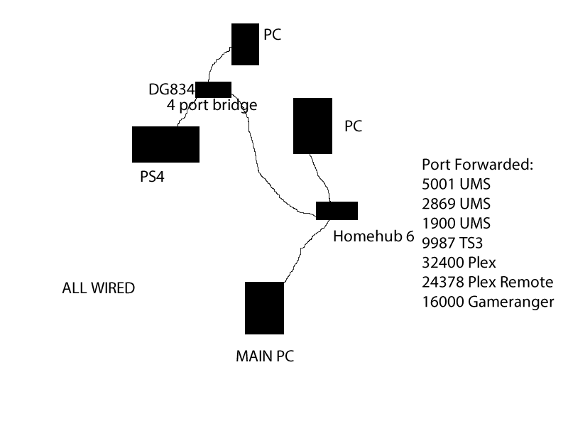

I have attacthed a horrible picture of my network setup to try and help you understand my setup....I thought that the port forwarding on my router was to driect my other pc's and ps4 to my main pc. Is that wrong? I have to be honest I like playing with networks but dont fully understand how they work.

Hubs and switches doesn't impact these signals so they can be ignored. Only routers "count". The DG834 seems to be an ADSL router, so I assume it's your internet router. If all is wired, you shouldn't have to change anything in it. It seems to have an internal 4 port switch in it, which I assume you to connect the PS4, one PC and the hub to. You should not do any port forwarding in this router for any UMS ports.
Which PC is running UMS, and how are the IP addresses configured? Are you running DHCP in the router, DHCP on one of the computers or are you using static IP addresses?

All im using the DG834 is literally a switch so my PS4 and a PC connect into that. Then another ethernet cable runs directly to my BT Homehub 6 which is my main router and then 3 other PCs run into that Hub. The main PC which I use is to the bottom of the picture. Everything is wired. The port forwarding is on my homehub which I have listed which ports are open.
The Main PC pictured is the one running UMS. IP addresses are allocated automatically by Windows 10. DHCP is active on the Homehub6. I believe they are dynamic ip addresses
