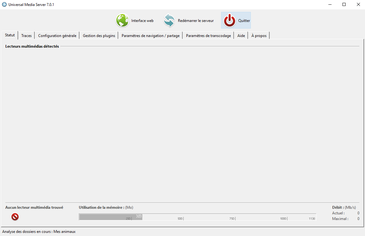

Hi, i got the same error as this guys viewtopic.php?f=9&t=12516
But i didn't understand how he solve it
He said:

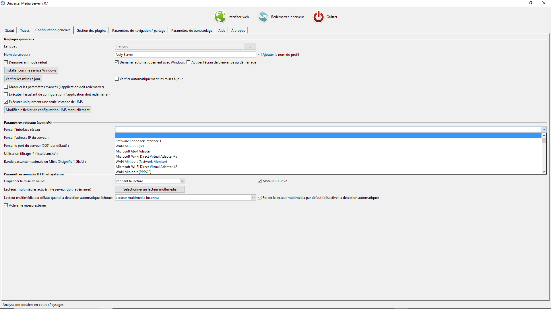

force networking on interface
setting and resetting the router
I've open the option but what i should select ? and "setting and resetting the router" what setting/resetting? on UMS or the box (192...etc) ?

Re: UMS no longer appearing on any devices PART_2
One symptom can have multiple causes
You don't need to "force" the network interface as UMS is already choosing the correct one as far as I can tell from your log. You only seem to have one network interface with a configured IPv4 address, so the choice is simple.
Since you're running Windows 10, the reason is probably the usual one: You have updated Windows (not like Windows 10 gives you a choice) and have reset the firewall rules. Try to disable the Windows firewall and see it that solves it. If it does, you'll have to grant UMS incoming access in the firewall for it to work. You can find other threads about that on this forum.
