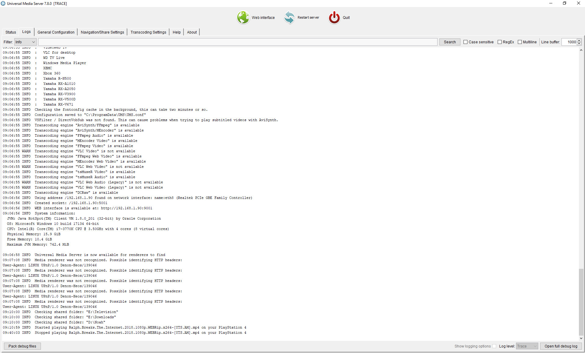

Long time user, love the application, but recently I've been having trouble. I have the latest version of UMS (7.8.0), Java v8u21 (build 1.8.0_201-b09), but issue was happening previous to those versions. Basically I load up UMS, turn on the PS4 Pro (IP 192.168.1.179 in logs, connected wireless), select a file to play and it will randomly stop playing. When it stops, the media player app returns to default screen and will not detect UMS until the app is closed and fully restarted on the PS4. I've uninstalled and reinstalled java and UMS (both full clean installs) on the PC, and uninstalled/removed cached files/reinstalled the media player app on the ps4. The issue does NOT seem to appear with another PS4 Pro on the same network, only difference appears to be that the second one is hardwired to the network. Is there a setting I'm missing somewhere to correct this? Signal strength on wireless is excellent, model is Asus RT-AC3100. Nothing else on the network is misbehaving.

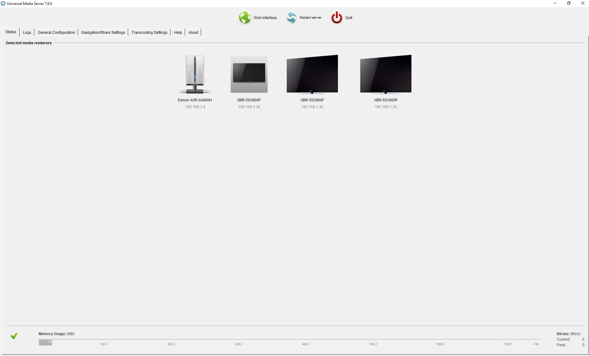

Side note, note sure if my TV is causing it...it's the Sony XBR-55X900F, noticed it's showing up 3 times in Status screen, and that's the TV the PS4 that's causing problems is connected to. Attached Trace log and screenshots, hoping for some direction?
