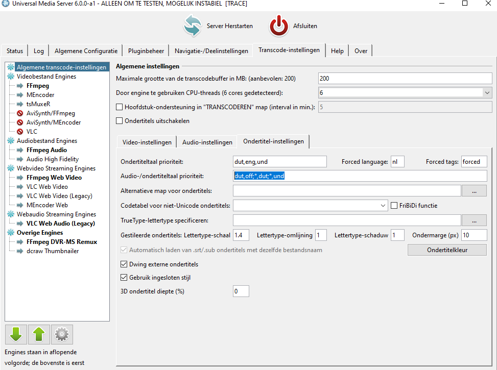

It works with UMS 6. I've attached log and a screenshot of how the settings look. Should I now just try these values with the new version?
Update: Tried with the latest version and same settings. Subs don't appear.
