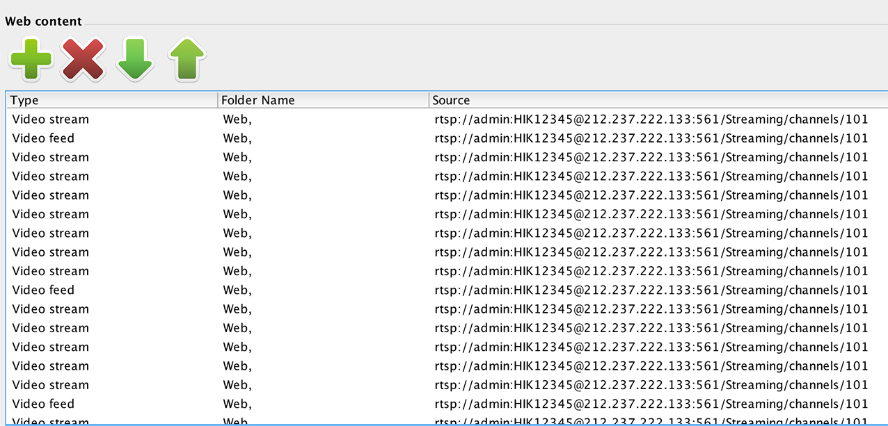

Using Mac version 9.8.0 - for which many thanks - I was experimenting with sharing RTSP URLs of my CCTV camera and saved one as a web URL, one as a podcast and one as a live stream. None worked so I tried to delete them, which proved impossible. In fact every time I tried to delete a saved rasp url, UMS created several additional new ones so that I ended up with maybe 50 saved entries instead of the original three. I'm using Os 10.13.6 on a 2017 5k iMac and I successfully managed to share some video and audio files before my web test.

- UMS web entries.png (201.22 KiB) Viewed 7794 times

This seems like a bug for sure. Instead of waiting for a fix, if you want to get rid of them, stop UMS and open UMS.conf in a text editor. Find the lines there, and delete them. Save and start UMS, and they should be gone. I don't remember the location of UMS.conf on macOS, but I'm sure you can find that references many other places on this forum if you can't find it.
Re: Web entries duplicate when I try to delete them
Thank you @Nadahar. They were actually in WEB.conf (user/library/application support/UMS) and I have now deleted them.
For the record, my original 3 lines had spawned an additional 1,134 replicated lines as a consequence of trying to delete them.
Ah, my bad. Of course they are in WEB.conf
