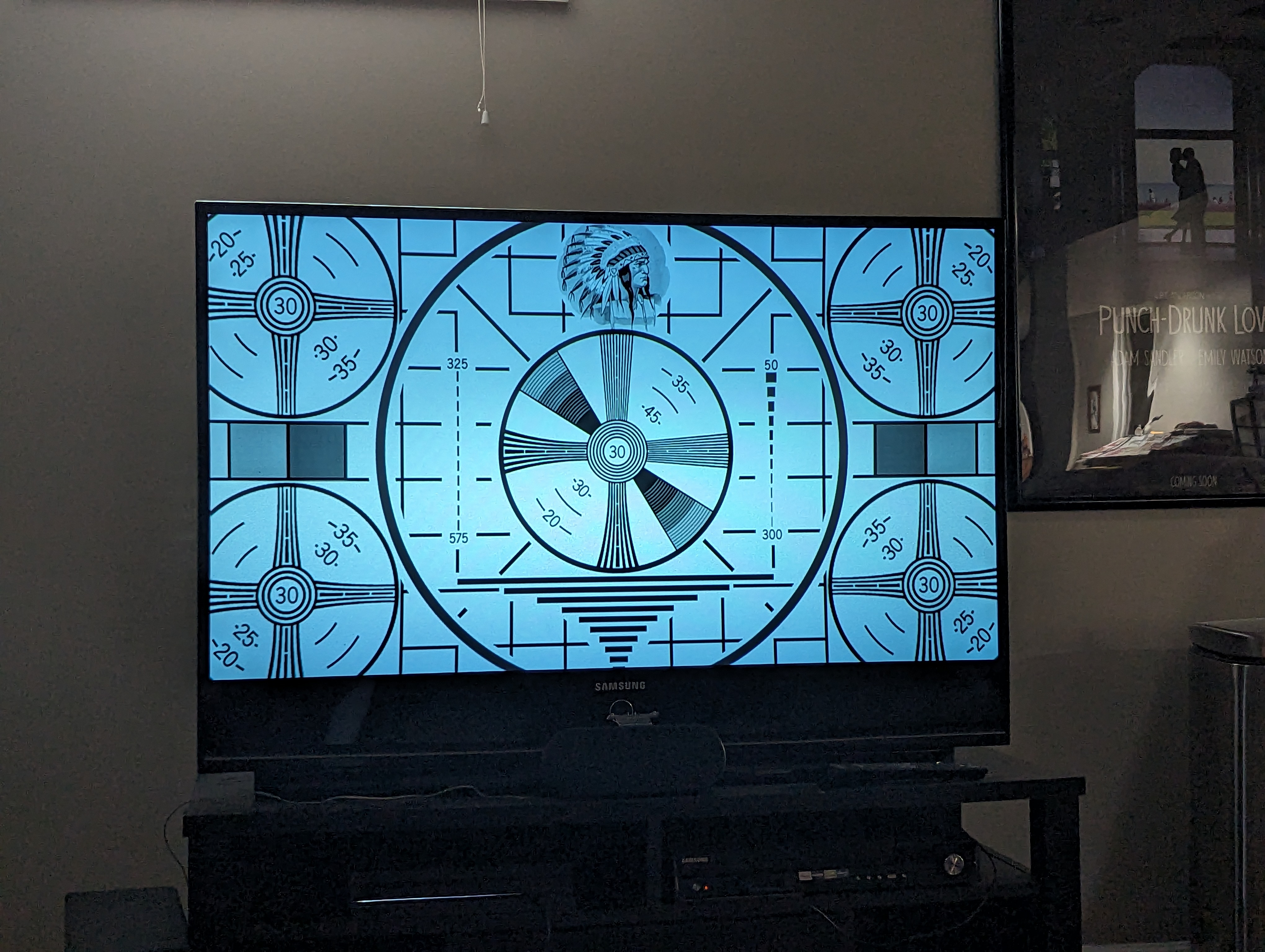

Removing the `expand=-152:-80` seems to resolve the issue, but removes the overscan compensation. I've come to the conclusion this is actually a mencoder issue, because the exact same command works on an x264 file, but causes the half-green screen issue with x265. I'm not sure where to follow up with them about issues, though.
Getting to what you were saying about overscan compensation, I'd love to avoid it, but I've spent hours looking in the past, and this TV is just bad, lol. It's a Samsung HL-T5075S, it's actually pretty old, uses DLP tech, technically only does 1080i/720p. I've looked high and low, and all I can find is that it's got really bad overscan, and there doesn't seem to be any fix, short of adjusting the projector's physical location, which would cost more money that it's worth. FWIW, here's a link to the manual: https://mans.io/files/viewer/14697/29

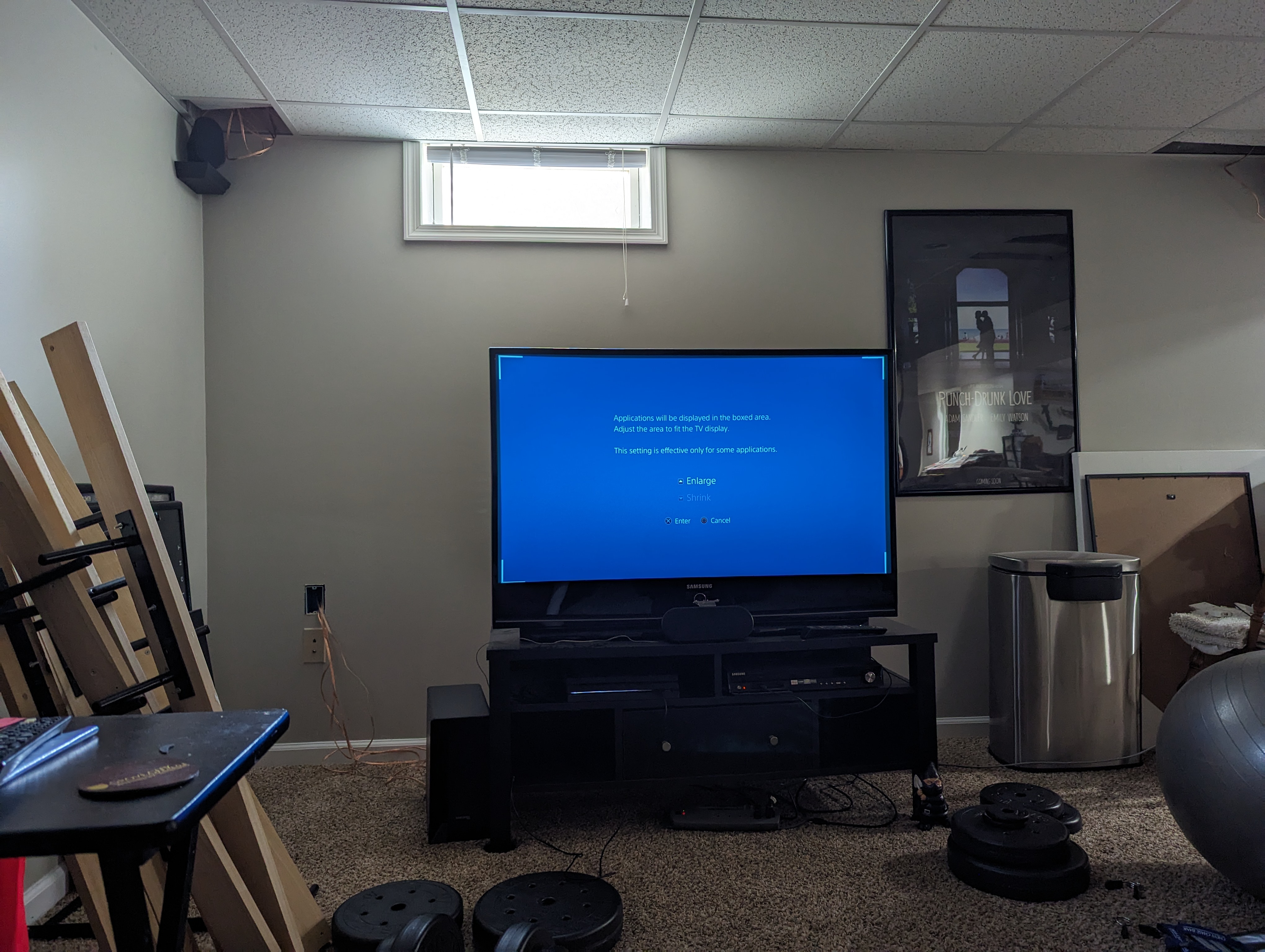

As for the PS4 settings you mentioned, that don't seem to do anything useful. I'd previously adjusted it as small as it will go, and I can see the lines in all the corners, but it doesn't appear to apply to UMS. It doesn't apply to Hulu either, which for some reason positions subtitles differently than other apps, causing them to frequently run off the bottom of the screen. I'm attaching 3 screenshots, the first is the PS4 setting you'd mentioned, you'll see it's as small as it can get. Next, I have two runs of the same test pattern, once without overscan compensation, and once with. You can see the difference - both are with the PS4 setting as small as it will go.
Speaking of which, I have an override for FFMPEG set in a configuration file specific to my PS4, but it currently doesn't seem to be working... I haven't yet had a chance to mess around with it.
I would love to be proven wrong about either of those two things! I'm mostly just waiting for the TV to go bad so I'm forced to replace it.
I thought maybe you were on to something with the network speed, unfortunately, after finding a cable long enough, it doesn't seem to be making any sort of difference. I'm also unsure of how reliable the UMS estimated speed is. I tested the PS4 network connectivity after switching to wired, and it was pulling 220Mbps down, but UMS is seeing only 50Mbps, on a good estimate. Regardless, trying the same x265 encoded file will frequently still fail and fall to mencoder, leading to the half-green screen. Usually, I can get around it, by manually specificing I want to use FFMPEG, and retrying after it fails the first time. I'm wondering if for some reason FFMPEG is taking a split second too long during transcoding, leading it to think it's failed?
PS4 Overscan setting:

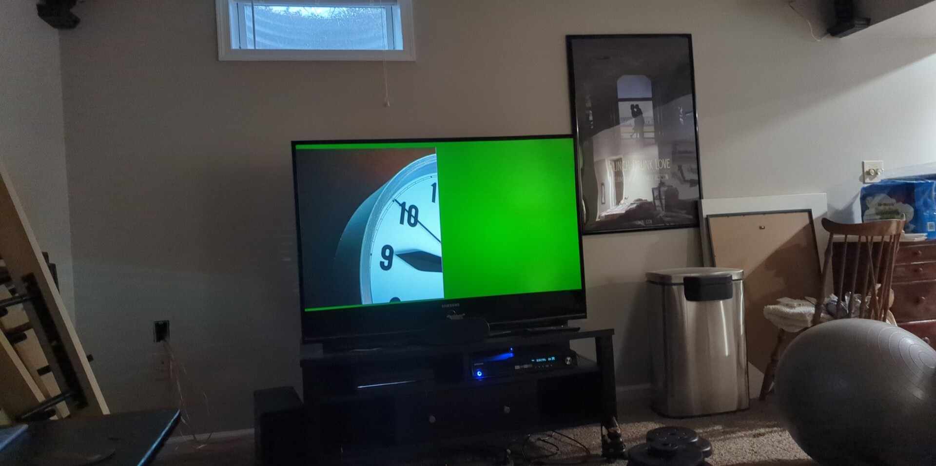

Brief addendum, the mencoder issue seems to be specifically tied to 10-bit x265 encodings. I ran the test pattern through ffmpeg and encoded 3 files, all HEVC, one 8-bit, one 10-bit, one 12-bit.
  • The 8-bit file played perfectly
  • The 10-bit file did the half-green screen, I also noticed the horizontal overscan compensation wasn't correct on the half it did render.
  • The 12-bit file errored out, which I'm not currently concerned with, but thought I'd note

I think the screen mode you want is "Wide Fit" but being a DLP TV I don't think you can avoid the overscan unless, like you say, you can reposition the projector.
It may actually be possible to do in the TVs service mode but could mess up alignment. I did find the service manual for it here. Using an adblocker I was able to get rid of the popup saying you need to buy it to view.
I did a little searching and found this
I have since found that in order to adjust for overscan by renaming HDMI1 to PC the input source must be 720p, not 1080i.
That was just one page in a long thread so there may be better solutions if you have a look through.
I think I have seen somewhere that mencoder has a problem with 10 bit, but it may have been HDR related. I don't know if 12 bit is supported.
It may be better to use FFmpeg instead and can add custom options to the transcoding command from the renderers conf file to add padding that would add the compensate for the overscan. This is from the defaultrender.conf

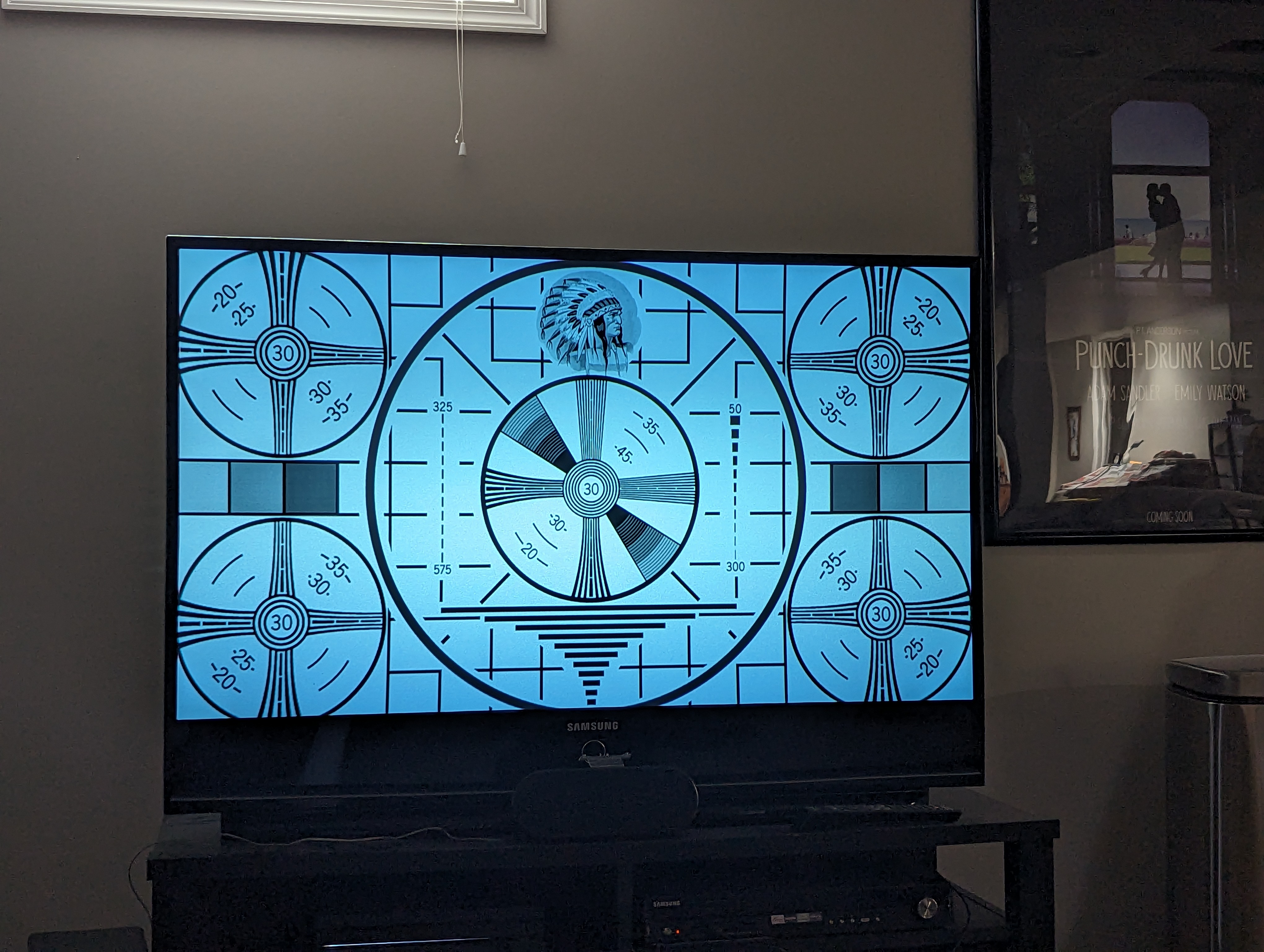

Good news! The renaming of HDM1 did the trick, the TV no longer has massive overscan! Unfortunately, from what I was reading, this does mean it's doing some scaling, but it might be the best I can get until I replace it, so thank you for the assist!
Because I'm no longer scaling anything, I shouldn't actually encounter the issue with 10-bit x265 encodings and mencoder, nor does it matter that I can't get the custom conf to load.
