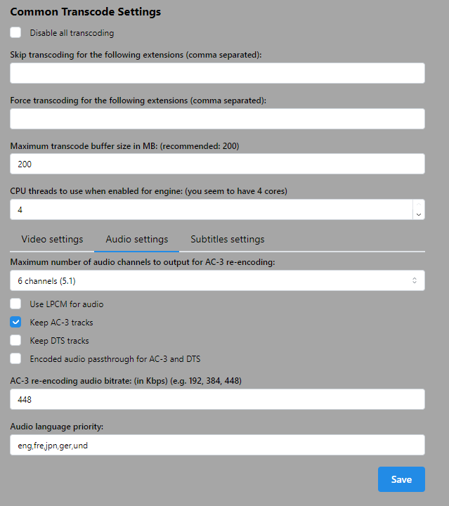

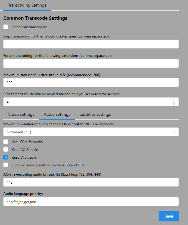

My current setup is:
Example: I play an .mkv file through UMS and the file contains three audio streams:
I tried with different settings and no luck
(screenshots attached) and I am curious to find out where the issue is - is it with UMS or with my TV, or both
Any advice would be really highly appreciated, as this is quite annoying and it would be a complete bummer if I am unable to play those video files that have a DTS audio. Thank you very much.
- UMS: 14.8.0 (also uploaded a screenshot of my audio settings)
- Windows: 10 Pro
- TV: Samsung QE55Q70DA
- AUDIO1........: English DTS 5.1 @ 1510 Kbps
- AUDIO2........: English AAC 2.0 @ 128 Kbps
- AUDIO3........: English AAC 2.0 @ 128 Kbps

- Opera Snapshot_2025-01-04_164615.png (43.6 KiB) Viewed 6622 times
- Opera Snapshot_2025-01-04_163752.png (42.2 KiB) Viewed 6623 times
