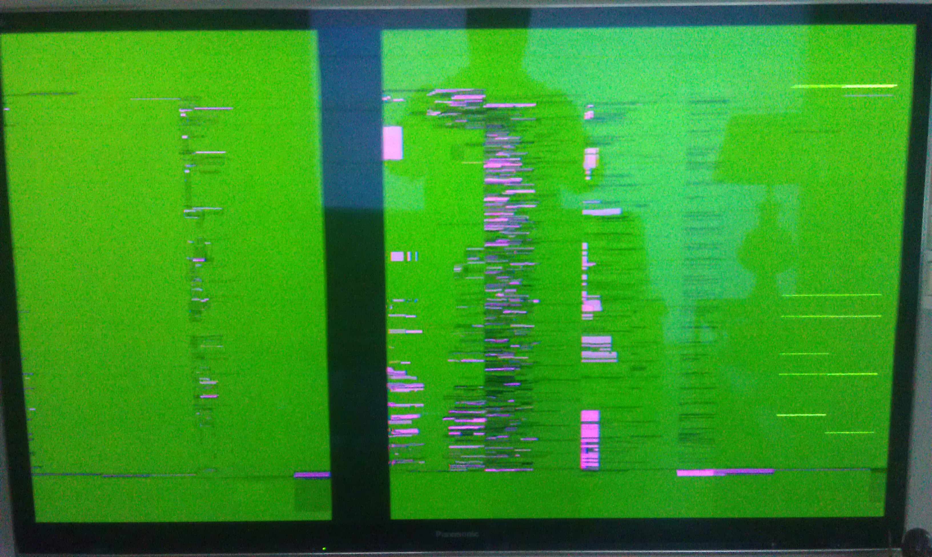

So with the previous version of the media server i had to make a personal conf. file wich i did and it worked. Recently there was an update and it no longer works, i tried changing the conf. file again but so far no succes.
I would love to show you a bug but unfortunately nothing shows up in the trace loglevel besides started playing "name of video" and stopped playing "name of video".
That being said i will show what i get on screen before it stops playing on it's own, also a link for the old conf. fil and the file i tried to make now.

what i get to see on screen with current conf file
I hope somebody sees what i'm doing wrong and can help me.
