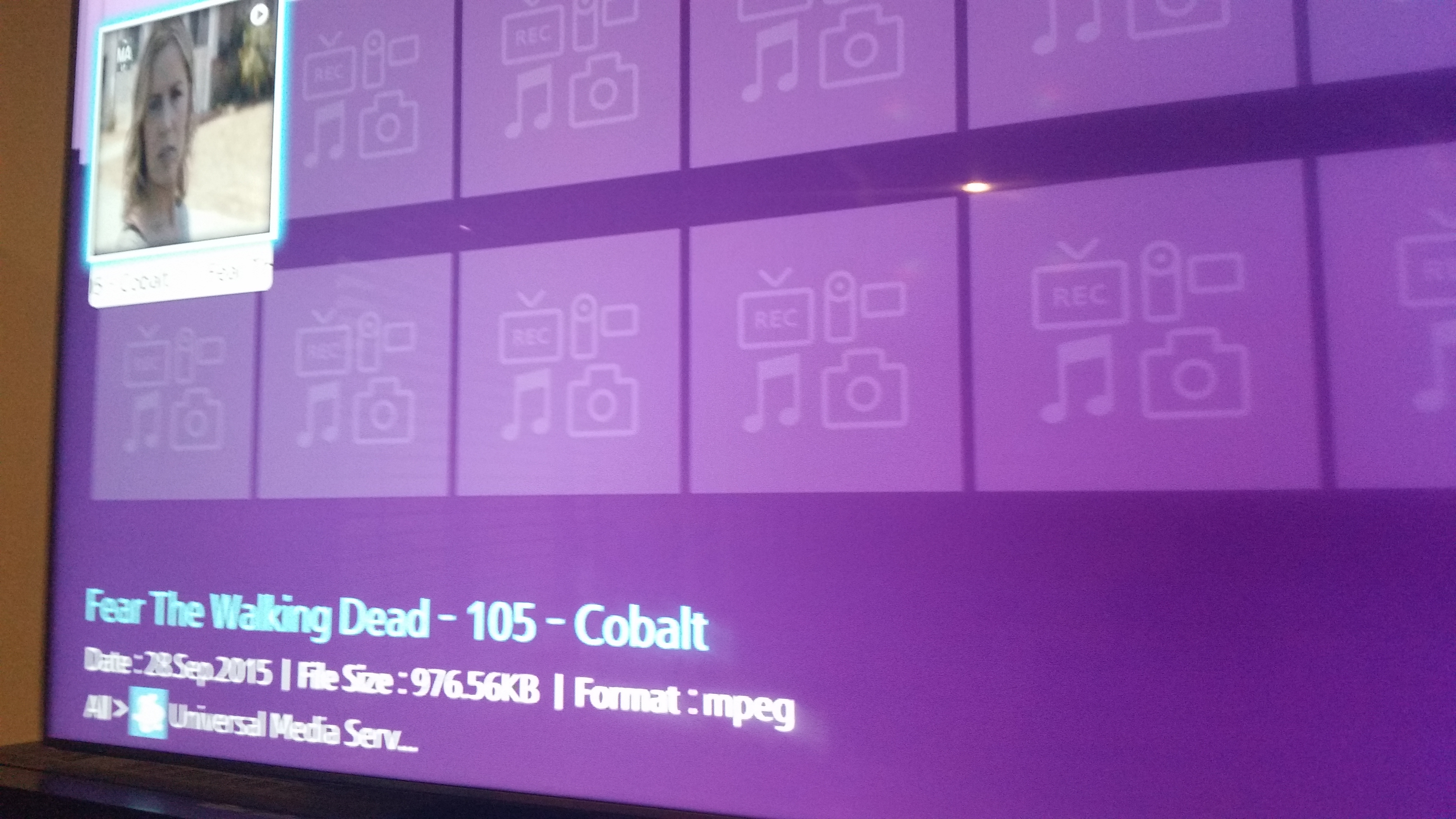

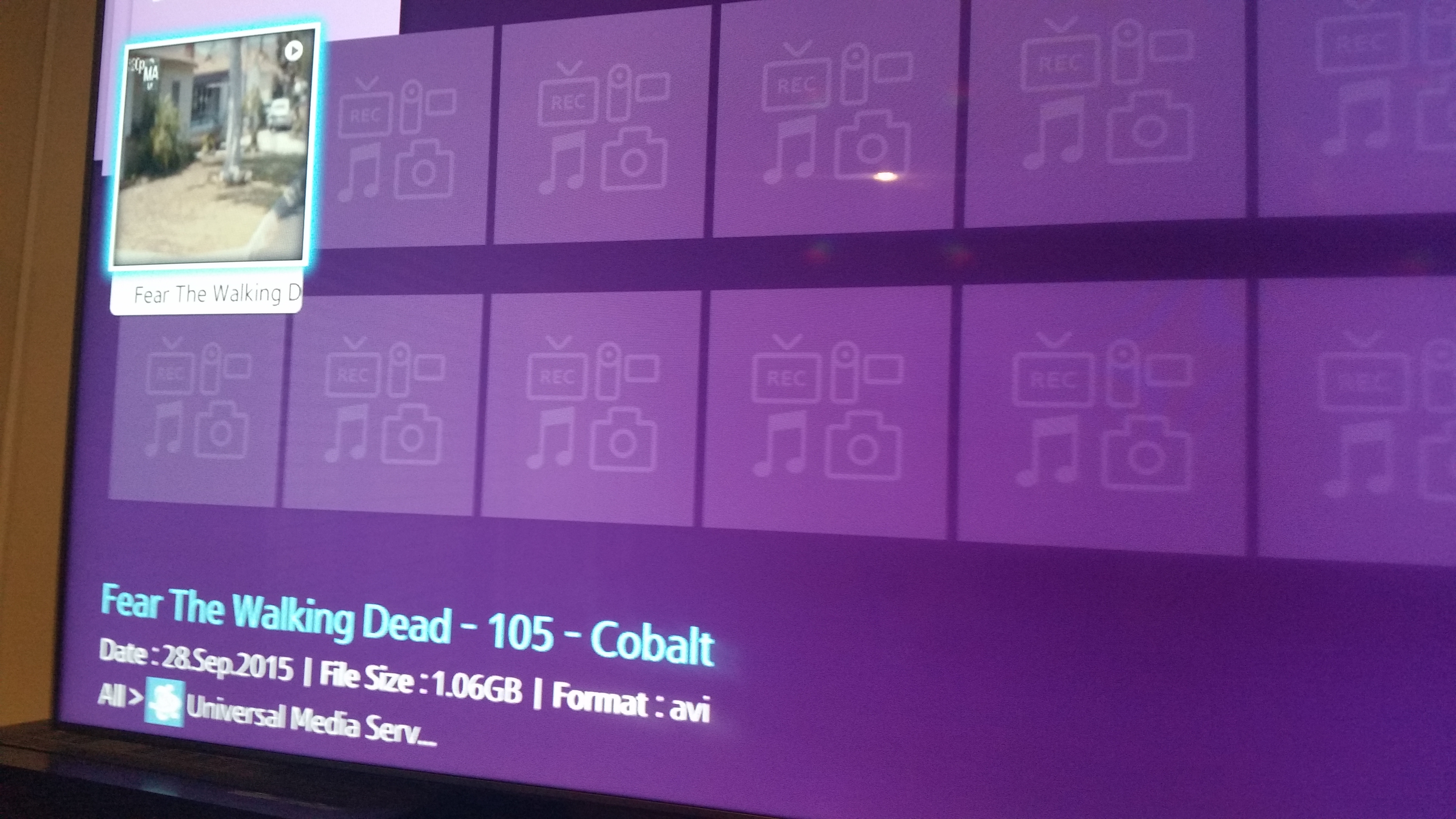

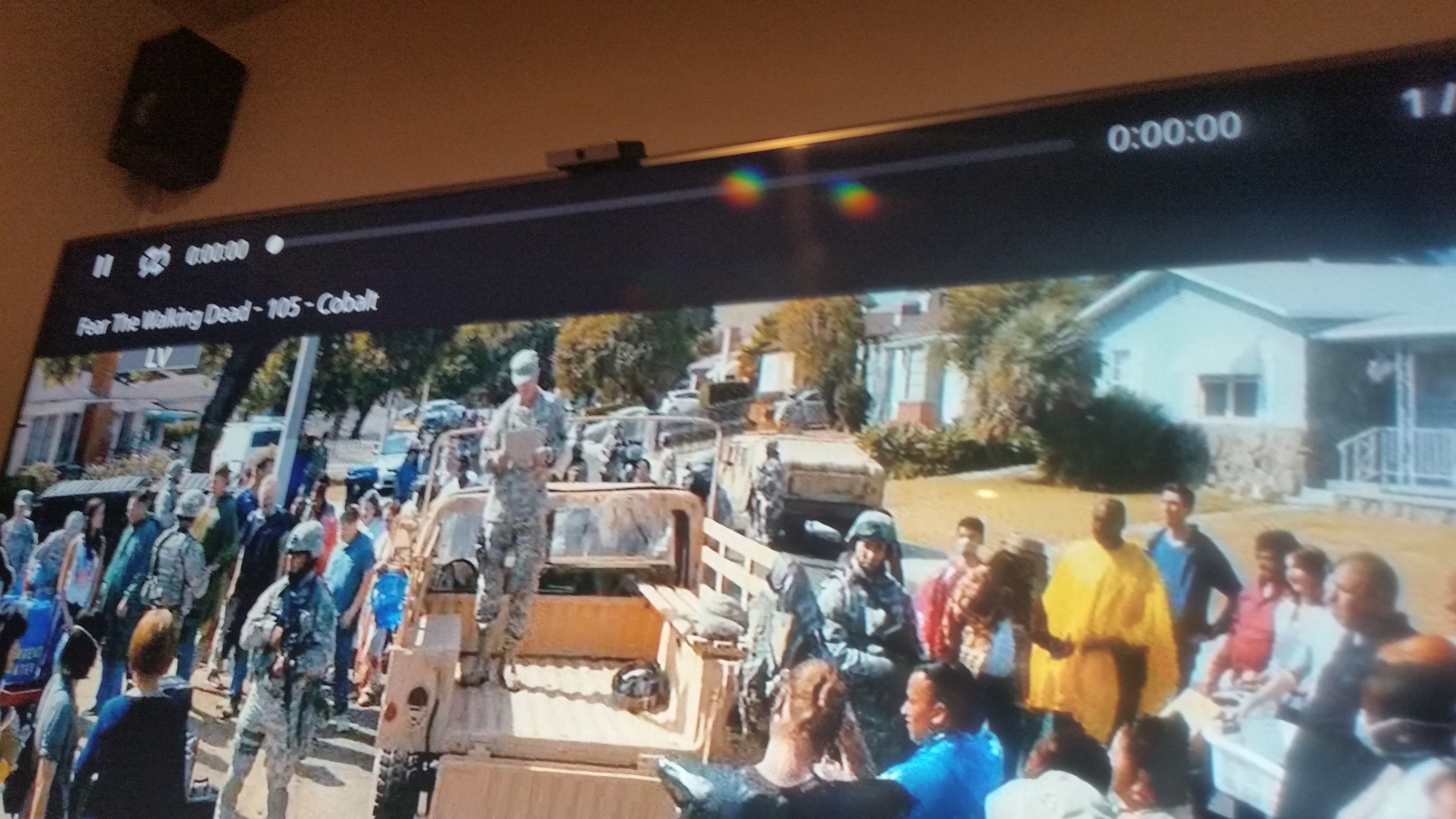

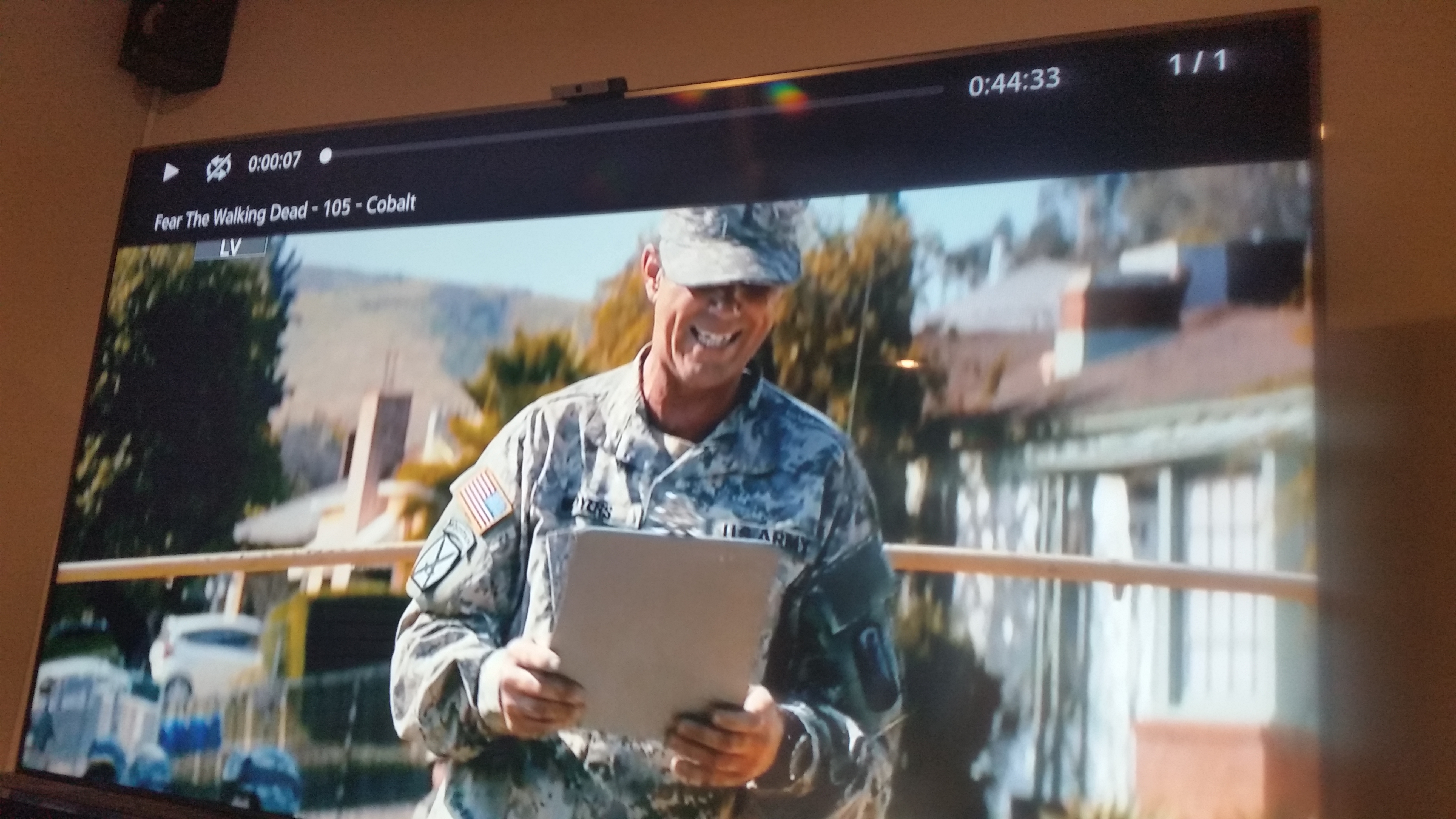

Hi Subjunk,
attached is log files from version 5.0.0 and 5.2.3, I did notice that a MKV will be noted as AVI when I was running ver 5.0.0 and when I upgraded it to 5.2.3 it says its a MPEG. I have also attached photos of the same title being run in version 5.0.0 and 5.2.3
Andy
Andy

Re: Upgrading 5.0.0 to 5.2.3 fast forward not available (Samsung UA55F7100)
remaining photos
- ver523-1.jpg (4.44 MiB) Viewed 11799 times
- ver500-paused.jpg (3.51 MiB) Viewed 11799 times
- Ver500-1.jpg (4.92 MiB) Viewed 11799 times
