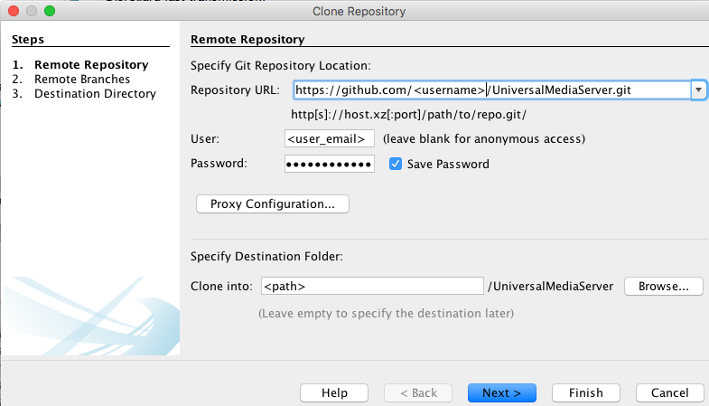

Nadahar wrote:... First you need to "fork" UMS on GitHub.
Done.
Then you need to check out your fork with git
Here I took the NB way: Menu > Team > Git > Clone… and Step through all three screens.
Screen Shot 2017-01-06 at 12.27.41 PM.png (61.29 KiB) Viewed 16456 times

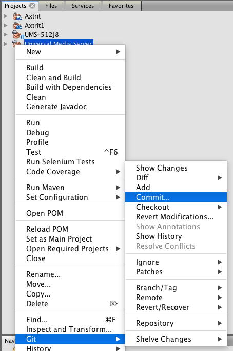

and "commit"
Done.
Screen Shot 2017-01-05 at 7.21.02 PM.png (68.23 KiB) Viewed 16467 times
