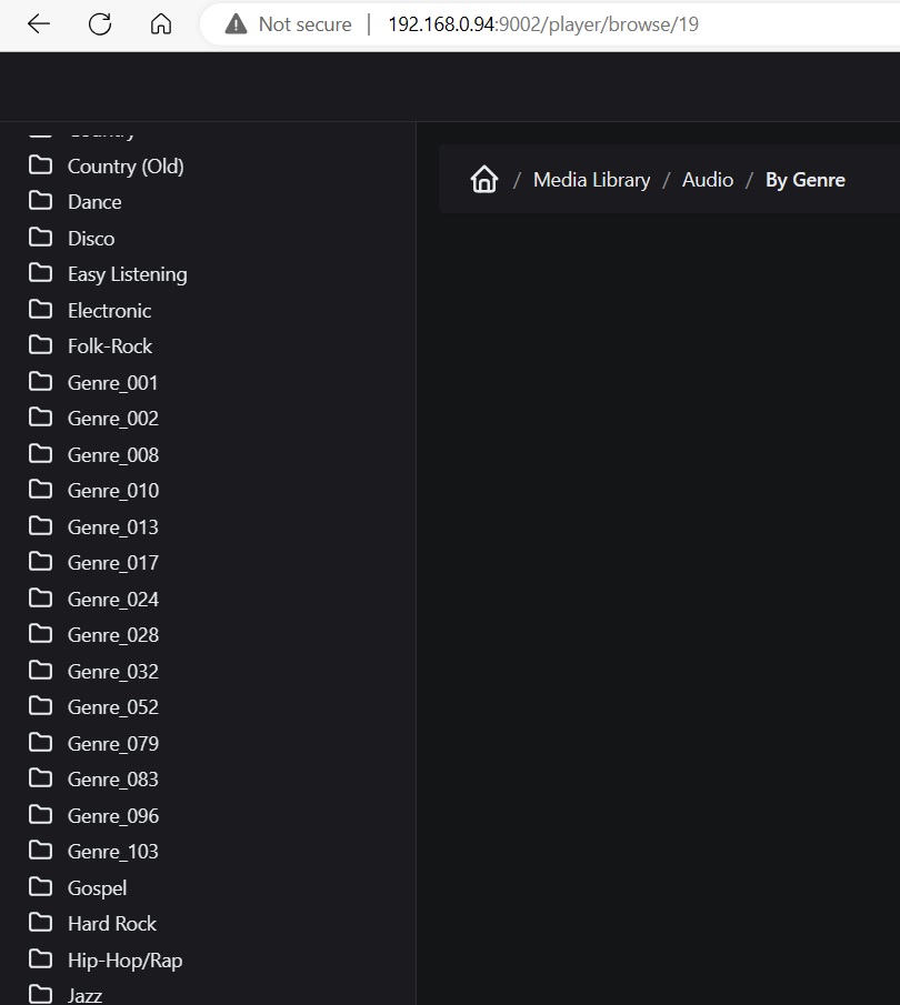

Well, here we are 7 years later and I'm having this issue! I have about a dozen "generic" genres listed, formatted like Genre_001, Genre_013, etc. I can match them with existing genres (that are populated correctly), but for some reason an album or two get incorrectly pushed off to these weird genres. For example, if the songs under "Genre_013" turn out to be "Pop/Rock", there are far more correctly listed under the actual "Pop/Rock" genre itself. And it does it to all songs in entire albums, not just one-offs.
As a retired software engineer, I did some debugging... The case is the same for those "IN" the right genre and those in the generic offshoot. There are no extraneous character[s] or spaces[s]. Help!

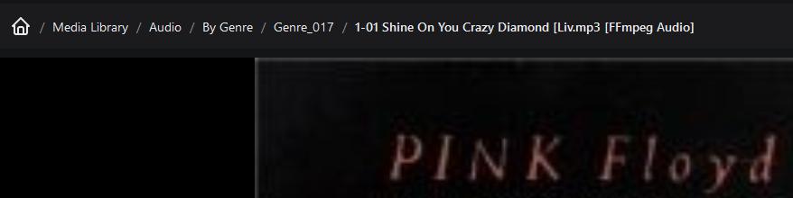

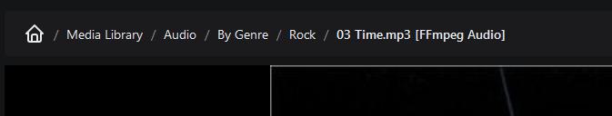

I had a quick look though the logs by searching for "Genre" and I do see "Genre: Genre_017" showing up quite often in the library scanner.
Interestingly I also see other files being picked up as "Genre: Rock" which as I understand from that link is also "Genre_017".
Here is an example from 2 files scanned at nearly the same time.
I don't know if there is any difference in the tags of these 2 files that could be causing it or a bug in UMS.

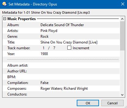

It could be helpful if you could post a screen shot of what other programs display for those 2.
Just checked on my computer and the Genre numbers show up for me too in the web player.
Comparing the metadata for those with one that shows correctly they are both the same so I guess its a problem with UMS.

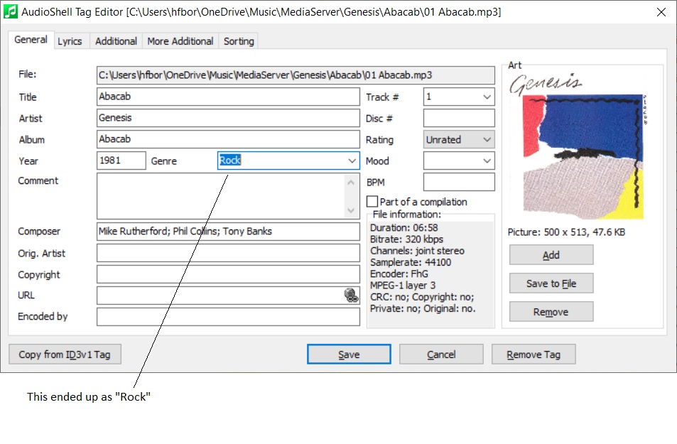

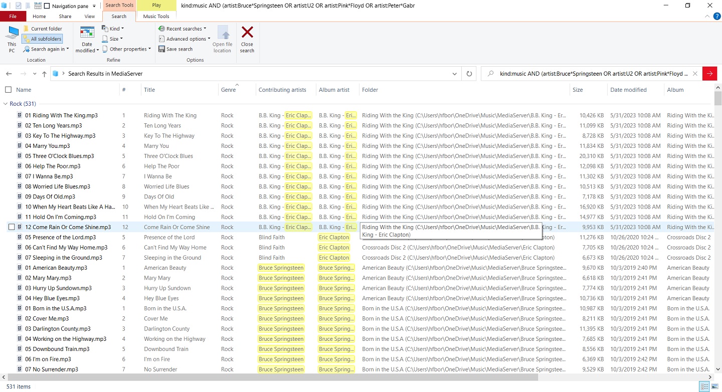

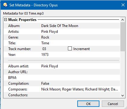

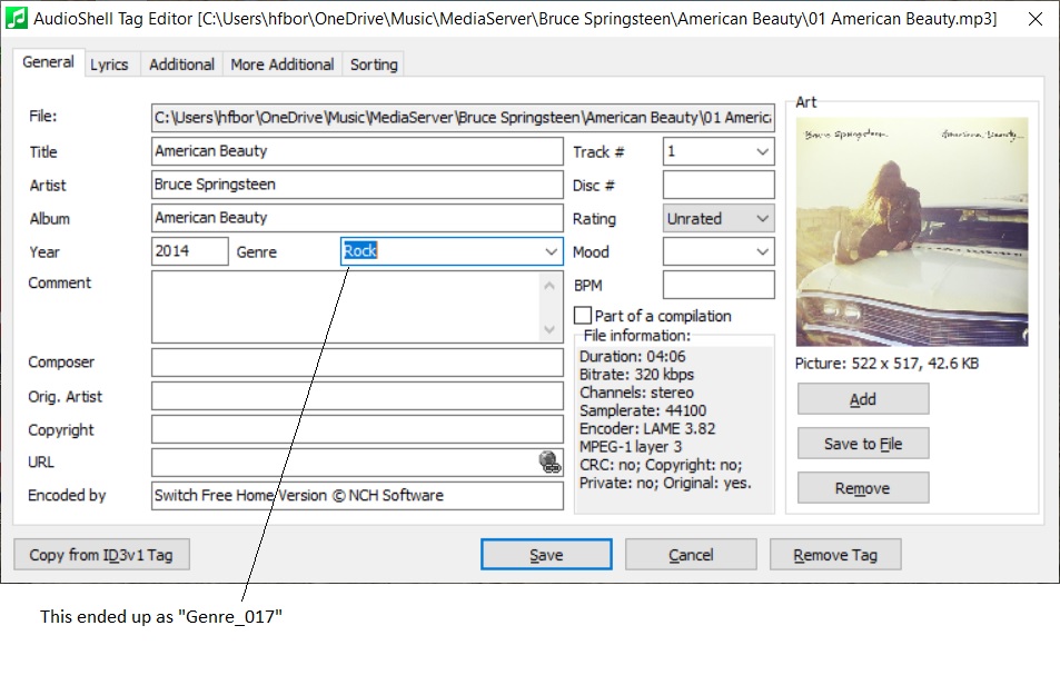

Thanks for rocking the quick response! I mentioned I'd done some debugging -- no extra space[s], no difference in upper/lower case, those kinds of things. I use AudioShell to set the Properties on my MP3s. (It's a great piece of Freeware.) Again with my programmer hat on, some observations. Note I can't process the data with anything since I can't request a download of the web player content. It's basically by eyeballing what I see comparing "http://192.168.0.94:9002/player/browse/163 (Genre_017)" vs. "http://192.168.0.94:9002/player/browse/187 (Rock)"...
1) It appears "all or none", album by album. That is, once it routed "Dark Side of The Moon" to "Genre_017", all songs on that album went there.
2) It may even be that each Artist goes one way or the other(?). I see Bruce Springsteen, U2, Pink Floyd, Peter Gabriel, for example, are "Genre_017". Conversely, The Doors, Eric Clapton, Mike & The Mechanics, and Genesis are "Rock".
3) Yet, for sure, all those artists have the same "Genre" property: "Rock". I did a File Explorer search "kind:music AND (artist:Bruce*Springsteen OR artist:U2 OR artist:Pink*Floyd OR artist:Peter*Gabriel OR artist:The*Doors OR artist:Eric*Clapton OR artist:Mike*The*Mechanics OR artist:Genesis)". Then I grouped by "Genre" and they are all in the same group, "R-o-c-k".
4) Just an observation, for anyone with the issue it seems "Genre_017" is consistently the misdirected "Rock". Are the URLs above the same? That is, does ".../163" always display "Genre_017" and ".../187 alway "Rock"?
Finally, you said, "It could be helpful if you could post a screen shot of what other programs display for those 2." I'll attach a few.
Good luck, Folks! Brings back a lot of memories of long days debugging code!
