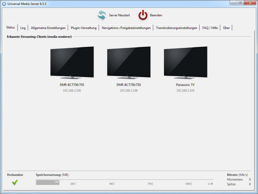

when I start UMS, in flag "Status" my devices were listed, but one device (DMR-BCT750/755) is shown twice (see attachment). However I only have one!
I have deinstalled and installed the UMS twice, the last time in clear mode. The problem still exist.
Do You have any idea to solve that?

I've done all steps You mentioned. Now I see diffenrent symbols but still having two equal devices (see attachment).
Further I made screenshots from device-preferences (see aatchment). They are different. Do You have an idea why?
Also I created a new log-file. May be that helps to find out and solve my problem..

don't worry, it's will stream fine
- In the "General configuration" tab, click on "Select renderers" and unselect "Panasonic" except your renderer. or at least the "TV" one.
That you don't have TV icon displayed with this renderer is normal, as it cannot found the fictive one i set, so it display the default one.
That you get your renderer displayed as 2 can be understood, as your renderer send 2 different informations about himself, as you already saw, so that make difficult to do general renderer configuration file without having this issue with your kind of renderer.
- Replace the renderer i give you by that one: That's said it's just an esthetical issue, as it'll stream fine on any one you'll choose.

You didn't disabled all the renderers, except your, as asked/explained.
So i guess that having 3 renderers icons displayed instead of only one don't bother you too much after all...
You can try that one:
