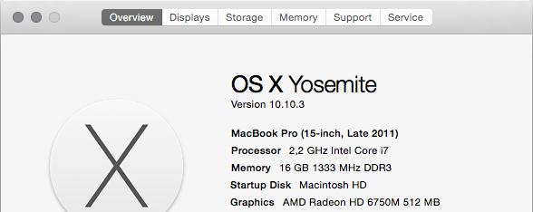

- Posts: 5
- Joined: Sun May 10, 2015 10:07 pm
Re: PS3 not found as renderer (but Chromecast is)
I tried several ports, but no cigar. Infuriating, right?
I added my mac specs as well if that's any help
- Screen Shot 2015-05-15 at 11.30.19 .png (57.48 KiB) Viewed 13907 times
- ums_dbgv3.zip
- (10.69 KiB) Downloaded 665 times
