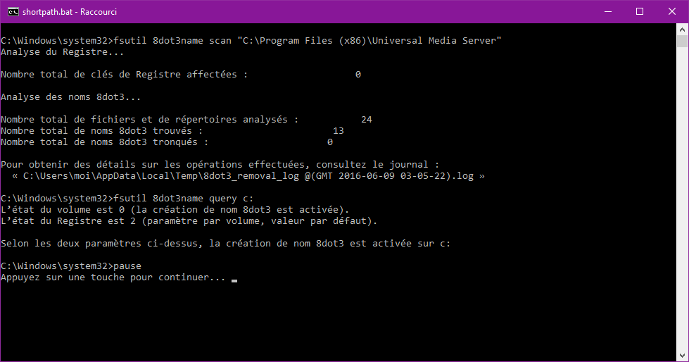

i just whiped up a small batch and checked my c: drive with fsutil:infidel wrote:, e.g. %~s is that it isn't guaranteed to result in a short path. It will only yield a short path if 8dot3 was enabled at the time the given file/folder was created. So if a user turns off 8dot3 at some point, %~s will give long paths for those files that were created during the 'off' period.
fsutil 8dot3name scan "C:\Program Files (x86)\Universal Media Server"
fsutil 8dot3name query c:
pause
Translating for you, basically the status i get for volume c: is 0 (8.3 creation is activated) and registry is 2 (default value, per volume). Are those the values you seek ?
Fsutil says after testing "According to the 2 values above, 8.3 creation will work on this volume".
i understand you need to know if the ums folder has an 8.3 path but the creation of 8.3 isn't turned off on my system, never has, yet i still get the yellow warning from your batch file when i install jumpy.
i didn't change any registry value pertaining to this setting, so yes like you said "if the user turns it off" i agree, but i didn't turn it off.
So i'm puzzled why i still see the 8.3 warning during install... Must be a lost in translation thing maybe, i seem to recall you mentioning it only works with english systems.
On that note, If you feel like expanding the setup's understanding of fsutil in other languages, i attached a text file containing the same results from the command line, notice the vowels with accents don't look right in the text file compared with the screenshot above. Taking this into account might help in detection of the fsutil values in french and maybe spanish systems if you use redirection operators in your batch file. it is in simple dos text, not unicode or utf-8.
Maybe some further testing needs to be done on win10 systems, it is still (relativelly) a new beast and M$ can change things at any point. But by all accounts fsutil gives a greenlight for 8.3 paths by default.
