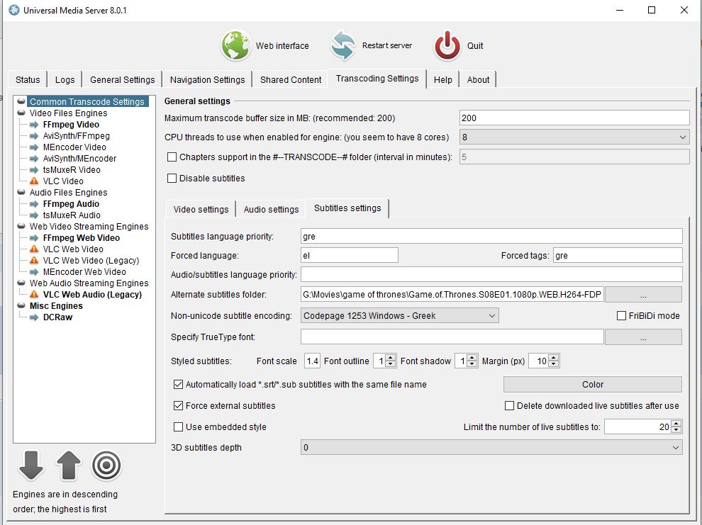

Re: srt subtitles stopped working a while back
I have same problem with this version UMS.Тhe subtitle file is not visible-in my case are Bulgarian.With old versions, everything was fine.What to do?
Hi guys, it would be useful to know what was the last version of UMS that had working subtitles for you, and please provide logs as per the Problem Reporting Guidelines
- for me the last working version regarding external subtitles is UMS-7.6.2
+ UMS-7.8.0 is the first version for this TV that continues suspended videos
Log of UMS-7.8.0
Log of UMS-7.8.0

Ok i hope i will get some help here in this thread.
I am searching for over 2 hours. read all i could read. I am trying to stream to my philips oled803tv
My problem is that i cannot set the greek language subtitle at all. Whatever i put in the subtitles priority or forced language fields i always have english subtitles on my video stream. I have an .srt file with the same name as the movie plus the -gre on its end.
as you can see in the picture i have used gre and forced language el ( used also gre there but nothing)
This is really strange because as it seems the media server streams subtitles properly to the tv. I need only to set my language there.
using latest ums-8.0.1 version
- uwp.JPG (135.15 KiB) Viewed 24129 times

dareios21 wrote: ↑Tue Apr 16, 2019 9:05 am Ok i hope i will get some help here in this thread.
Are you sure that the subtitle not is internal in the video file.
I got the Philips 873, it cant show external subtiltes, like .srt
If the videofile have subtilte build-in it can show the subtitle.
