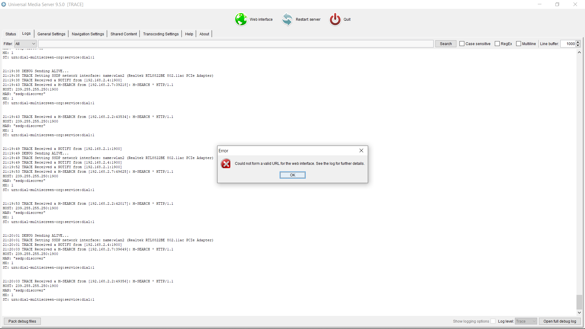

I have a problem, i cannot access web interface of UMS whenever i Press webinterface button it gives following error,
Screenshot (211).png (117.01 KiB) Viewed 6857 times
please help me to find solution i have attached log file in attachment
(394.12 KiB) Downloaded 524 times

In the log I see
ERROR 2020-06-25 21:17:14.762 [main] net.pms.PMS FATAL ERROR: Unable to bind web interface on port: 9001, because: Address already in use: bind
INFO  2020-06-25 21:17:14.777 [main] net.pms.PMS Maybe another process is running or the hostname is wrong.
It may occure when the UMS is runing as service and you try to run the UMS again. Or there is other SW is running on your PC and using port 9001

I Checked All Ports Using
netstat -a -n -p tcp -b this command in cmd
but no program is using port 9001

Can you try closing your web browser before UMS starts?

SubJunk wrote: Fri Jun 26, 2020 8:11 pm Can you try closing your web browser before UMS starts?
No Luck

Is UMS running as a service? You can check in the Windows program "Services" for one called "Universal Media Server"
