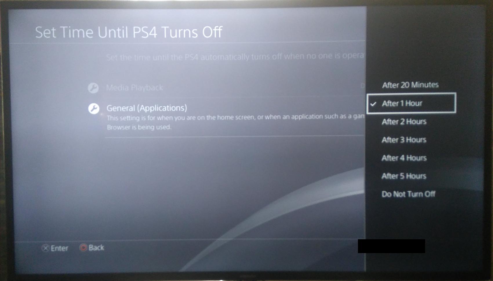

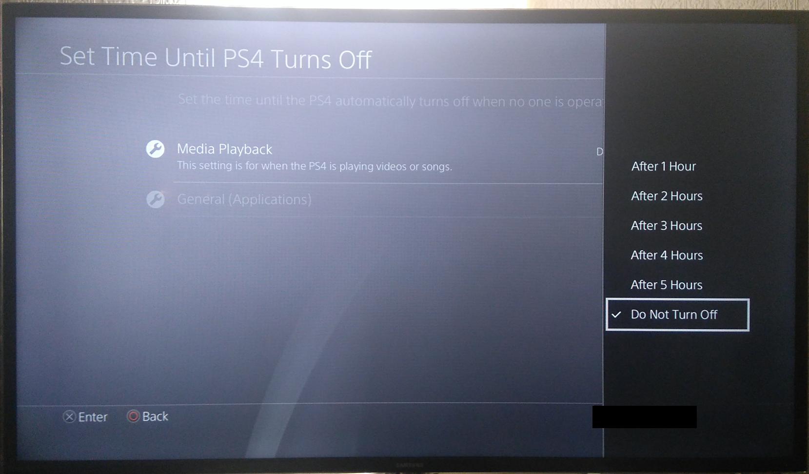

jeffreydvp wrote: Thu May 28, 2020 2:35 pm For people still running into this, there is a setting on the PS4 to automatically stop applications after 20 minutes. This was the issue for me. Simply increase the the time to stop applications to 2+ hours, or disable this functionality
Would you be able to share a photo of this setting with us please? It would help a lot of people and we can add it to our documentation
Posts: 1445
Re: PS4 disconnecting every 20 minutes

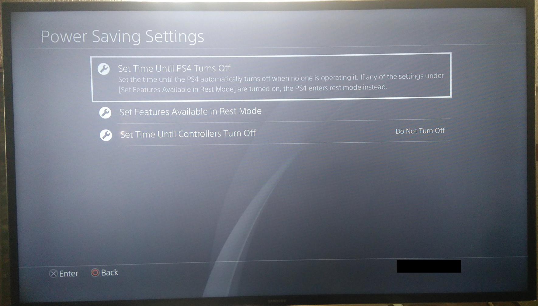

I have seen a similar suggestion somewhere else on this forum. I believe it was in the Power Saving Settings.
I don't think there was a media playback option on previous versions (I'm on 7.51) so that might have been the issue in the past but shouldn't happen now.
If it was just this option I would expect the PS4 to turn off, not just disconnect from UMS though. Looking though all the settings I couldn't see anything else that it could be.

mik_s wrote: Fri May 29, 2020 4:56 am I have seen a similar suggestion somewhere else on this forum. I believe it was in the Power Saving Settings.
This is exactly the setting I was referring to. Sadly, after making this change, the issue still occurred for me and is still happening. I went to go delete my post on here, but my post seemed to had vanished (I didn't realize the thread was paginated), so I didn't think it actually posted my reply
