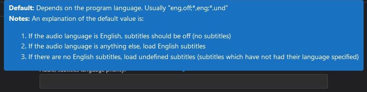

Check your language settings as they may not be correct. Might be better to delete what is in the box and UMS will use default values depending on your system language.
yours is set to
audio_subtitles_languages = eng,eng;eng,und;*,eng;*,und;*,*
Clipboard Image (7).jpg (3.95 KiB) Viewed 8069 times
Clipboard Image (6).jpg (44.37 KiB) Viewed 8069 times
If you always want the subtitles on the starting with "eng,eng;" looks correct.
Also it looks like the subtitles will be streamed to the renderer instead of being burnt into the video so see if you can enable them on there.
Is the conf one you made yourself? You have set "StreamSubsForTranscodedVideo = true" so this is telling UMS to just send the subs and let the TV handle them.
If the TV does not allow you to enable subs then remove this setting from the conf.
Your UMS.conf is very bare only showing things that have been set so I guess it was originally set up on an old version, or it was deleted and UMS recreated it without all the documentation.
I suggest you reinstall but select "clean install" to reset everything to defaults and it should work normally again once you set it up. Back up your custom conf file for that TV first though.
