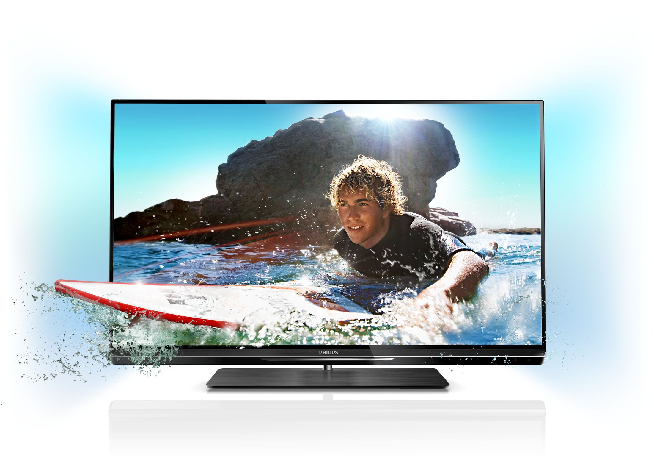

After testing, I can confirm this configuration works well with the Philips PFL6007 tv set (it should work for the tv sets from the same generation as well, aka 2012 PFL).
It allows to play more media types natively than the Philips-PFL.conf file.
This official picture could be associated with this configuration.
NB: that would be nice to choose a custom picture from a folder instead of gathering them all in a jar file. I hope it is changing for the future release.

That looks good and I hope it will be included in future versions of UMS with some minor changes to standardize it like the other confs.
For most of your questions @Subjunk will be better to answer them as there is a bit of trial end error to see what your TV can play, I mostly try and and help to get the supported formats correct if UMS is incorrectly transcoding.
AFAIK it should be possible to reference a device picture from your filesystem in the conf and are not limited to the ones in the jar. I have not done this myself but have seen another user do it but can't remember exactly how. I think you have to put the full path instead of having to place the picture in a specific folder.
