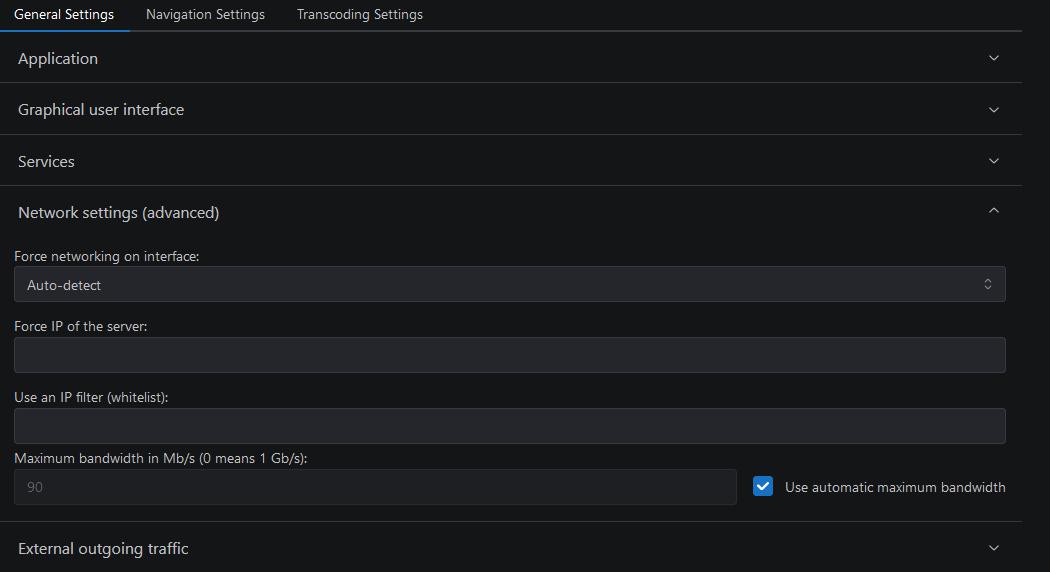

Check to see what network interface UMS is using, try changing it and see if that works.
It should use the correct one if set to Auto-detect but sometimes VPNs can confuse it.
Clipboard Image.jpg (40.27 KiB) Viewed 1297 times
For anything else I will need to see logs (see the section in red above)
