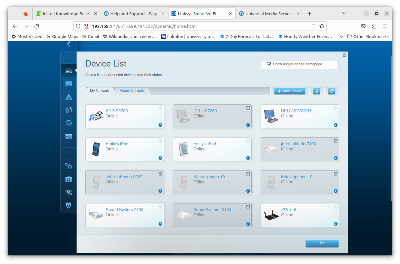

new to UMS and using Ubuntu 22.04. my current renderer is an off brand called Cobblestone from Muzio. Default device name is Sound System 2100.

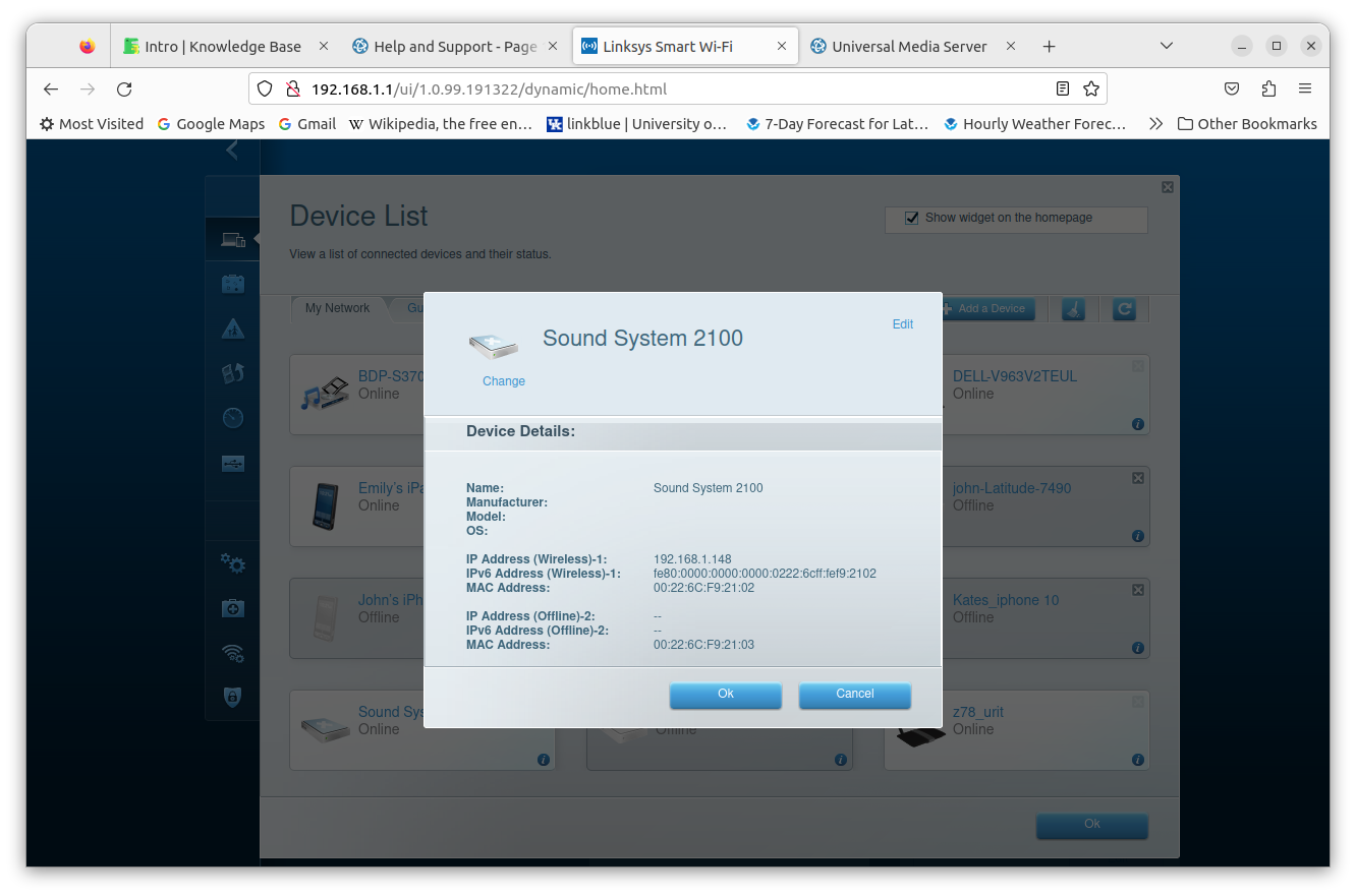

I use it successfully using Apple AirPlay on wireless on iphone and itunes. It does not show up in UMS as a media renderer using wireless network. It does show up as a renderer in UMS when connected to router thru wired connection but it still doesn't function. It only shows the local network IP address and basic device info. Thus I can only play music files thru the speakers on my laptop which is functioning as the server.
I am including debug and trace output files from wireless network connection and some images from router, Linksys 6350, and from linux network probe.
The debug file shows only a partial listing as the whole file was too large but the content is representative.
- router device list.png (198.71 KiB) Viewed 2647 times
debug log partial.log
- (136.11 KiB) Downloaded 466 times
- device info from router.png (192.92 KiB) Viewed 2647 times
