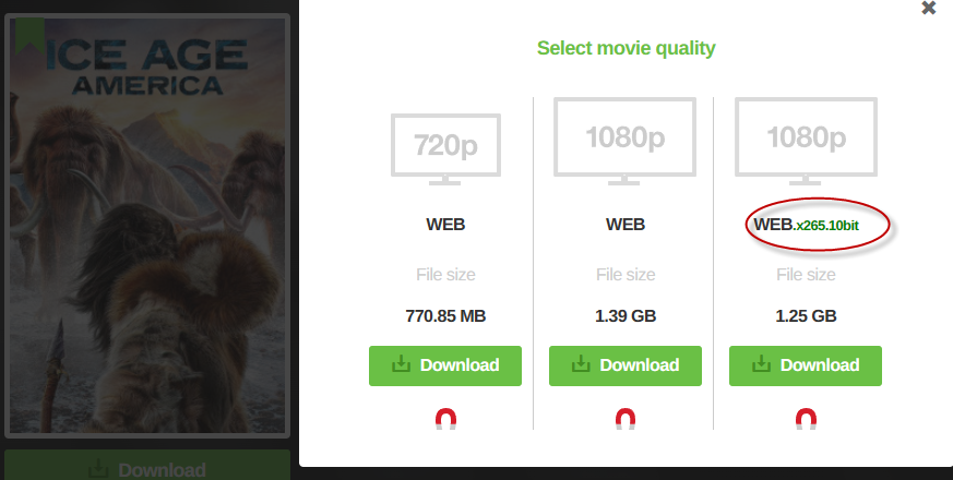

When looking at the specification of the Blu-ray I notice that the format HEVC (H.265 - Main, Main10) is supported. [https://downloadcenter.samsung.com/cont ... 180111.pdf] So, I downloaded a few movies in that format and that my TV only support 1080P.
[https://yts.mx/movies/ice-age-america-2023]
x265 10 bit.png (164.78 KiB) Viewed 5012 times

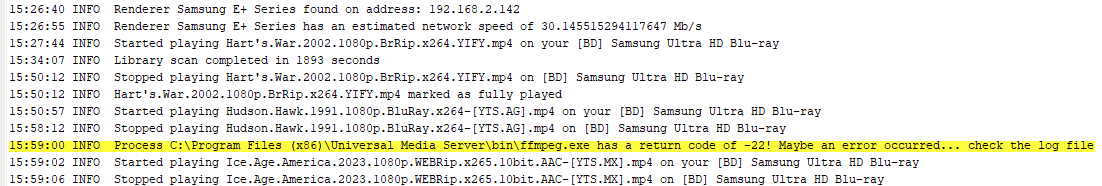

To my deception I got a message on my device "Please check you network connect". But in the Trace tab in the UMS I get the following message.

There is not a conf file for that device yet so UMS is picking something close, but thinks that video format is not supported and is transcoding it to something it thinks is.

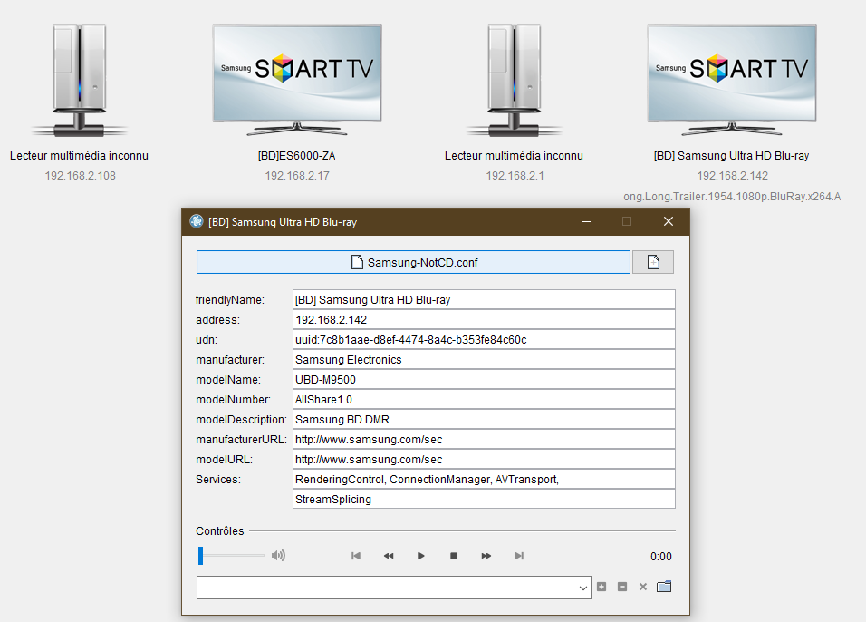

One thing was confusing me is you have 2 Samsung BD players on your network and neither of them have confs for them. The only one that gave a model number was [BD]ES6000-ZA which is this one but on page 10 does not list h265 as supported.
I realised the one you linked to was a different model so had a closer look at the logs and saw one with "Samsung Ultra HD Blu-ray", but no no other identifying headers which is why I missed it.
I can't make a new confs for these as I have no way of testing and don't really have time, but I altered some confs from other devices around the same year as they came out so should support the same formats but this is not guaranteed.
Hopefully these will be picked up by UMS as there is not much to match with on your UHD bluray and if you change its name on the network it will not work anymore.
Copy them to "C:\Program Files (x86)\Universal Media Server\renderers" and restart UMS.
If you still have videos that do not play properly then try playing from the #--TRANSCODE--# folder and choose "No transcoding"
If this works then the conf can be tweaked to tell UMS this format is supported.

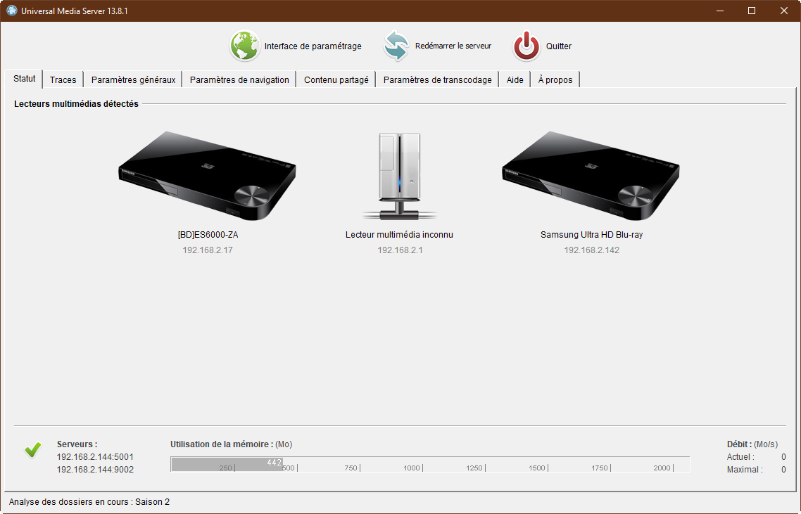

To concluded here is image of my Samsung Ultra HD on the UMS and the link to the user guide of the Blu-Ray that is Samsung UBD-M9500 just in case you have better .conf file to share with me or with us all.
Thanks!
Capiray
Before
Samsung Ultra HD Blu-Ray.png (72.09 KiB) Viewed 4882 times
After, but with no detail available for the devices.
Samsung Ultra HD Blu-Ray1.png (64.86 KiB) Viewed 4882 times
