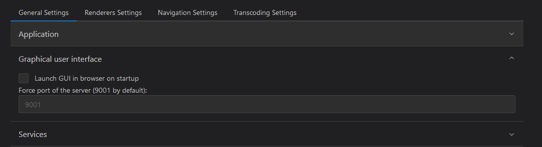

You can turn off the autostart of the web UI in the settings.

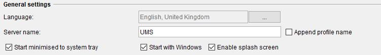

To stop the old UI showing on startup you can select start minimised to tray.

This also allows configuration on headless installs without manually editing the conf files, and ability to do it from a remote computer.
There were a few versions of V13 where this setting did not save so might be worth updating is this does not work.To stop the old UI showing on startup you can select start minimised to tray.
