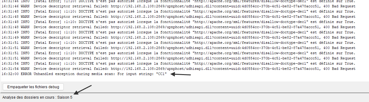

I Have notice that the scan of the files don't complete itself. Seem to freeze the process.This only started with this version of the UMS, as It is working fine with version 14.10.0.

There are a few warnings that have started to appear in the logs for people recently but are not important to UMS functioning so they can probably be ignored. This was mentioned on Github recently.
The only other error is a scanning a file with "CC1" subtitles
I have seen this several times but as that format of sub is uncommon it would help if the devs had this file to test with and fix this error.
Any chance you could upload it somewhere so we can get a copy? You can use something like google drive or mega.nz and send the link but probably better to send in a PM.
Besides that there is nothing else wrong in your logs so should be working fine (not counting that 1 video) and scanning is finishing I think unless this has stopped it.
TRACE 2025-02-19 16:32:00.696 [Media Scanner] net.pms.store.MediaInfoStore Store does not yet contain MediaInfo for I:\Séries\Magnum P I\Saison 5\Magnum P I 2018 S05E01 WEBRip x264-ION10.mp4
ERROR 2025-02-19 16:32:00.871 [Media Scanner] net.pms.store.MediaScanner Unhandled exception during media scan: For input string: "CC1"
TRACE 2025-02-19 16:32:00.872 [Media Scanner] net.pms.store.MediaScanner
java.lang.NumberFormatException: For input string: "CC1"

I think this is a much more serious issue than I thought.
I assumed this file was just ignored and the scanning would continue but when I had that video in my shared folder it would appear empty. Removing it restored the contents.
Scanning appears to stop too once it reaches this video so anything else won't be scanned.
I have mentioned this on Github so hopefully it will be a priority to fix.
For now just move that to another folder that is not shared and restart UMS and it should complete scanning.
It might be possible that you have multiple videos with this so keep an eye on the logs for errors and move any videos that show up.

This has just been fixed and is waiting for code review before being merged. It should be in the next release.
