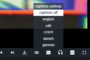

I'm going to need some examples of the videos that don't show subtitles. Can you upload them somewhere for me to test, along with the sub file.
Even better if they are MKV files as they usually have the embedded subtitles.
(I don't have anything to play 4K though so please only post 1080p)
Also post logs of you playing these videos so I can compare with what it will show for me as I don't have anything Roku.
This will help me to change the conf properly otherwise I have no reference.
Did that test5.mkv video show subtitles on the Roku. You already confirmed it works on the web player.
If those controls are not showing it is because the video does not have those data streams to change to.
I'll PM you a link to a recent video for you to try and see if it works in the web player and on the Roku.
I have the same video so I know it should work and can compare your results.

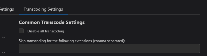

You could also try disabling transcoding altogether since you cannot play from the transcode folder ATM. (this will stop the web player from working)
You might find a lot of videos won't play but you should have some that will, and then it is up to the player to handle subs.

I tried disabling All Transcoding, nothing changed... so I reenabled it.
