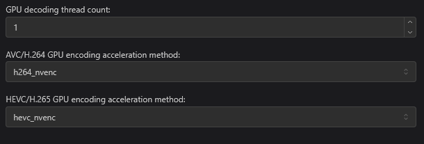

If you have a GPU that has a video encoder you can enable this in the transcoding settings for FFmpeg. It may be possible that the video can be streamed unaltered and the TV will just crop it to fit.
