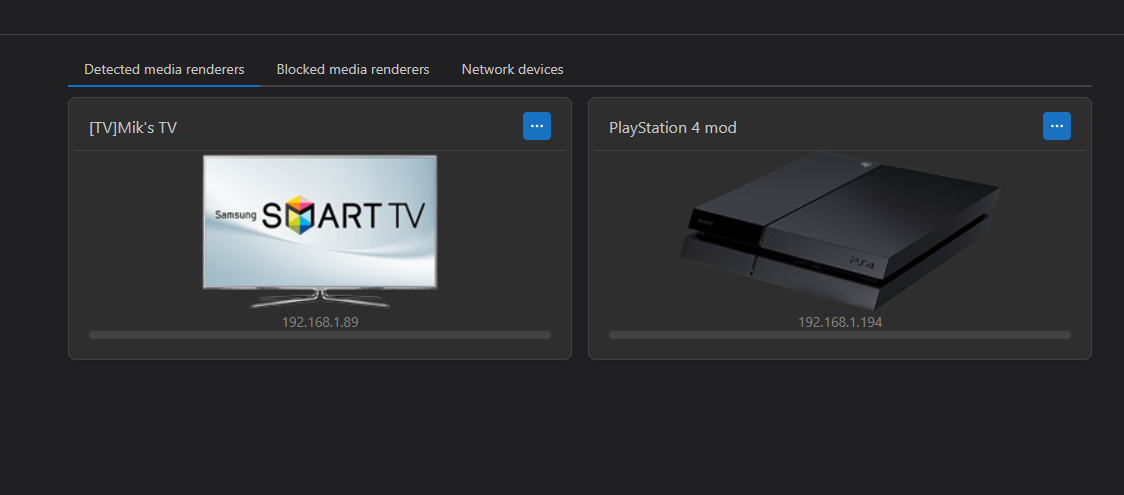

Posts: 1479
Re: I have a question about Setup
If you look on the web interface you can see what is detected. You need to set up the shares here in the shared contend section.
Screenshot 2025-06-26 025113.png (92.74 KiB) Viewed 1198 times
If nothing is showing I will need to see logs to find the problem. See the section in red above.
