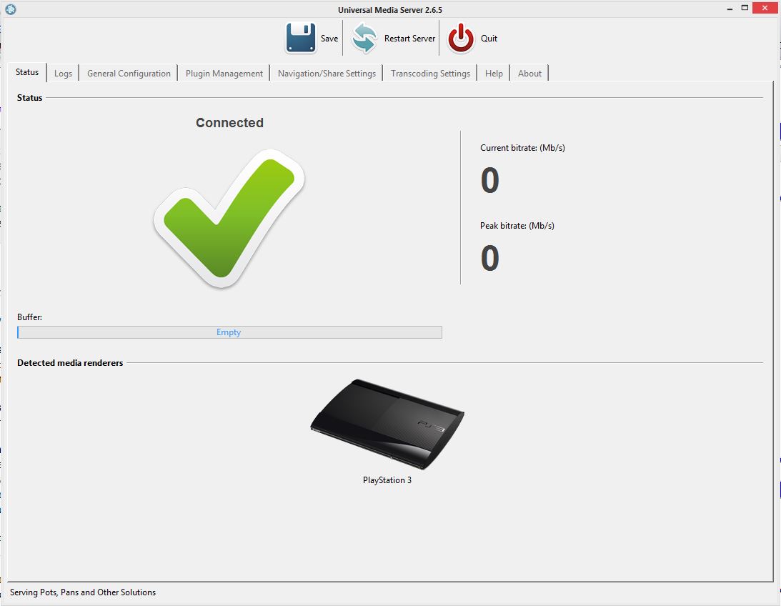

I have the same issue... UMS 2.6.5 works fine but when I look at the Status screen when serving it always shows:
Current bitrate: (Mb/s) 0
Peak bitrate: (Mb/s) 0
Buffer: Empty
Any way to fix this?
Buffer: Empty
Re: Buffer and bitrate does not fill up.
The buffer is only used when transcoding, but those files are streaming because the renderers support the files. So this is normal. If you want to force transcoding for some reason, there is the "Force transcoding" setting on the Transcoding Settings tab.
