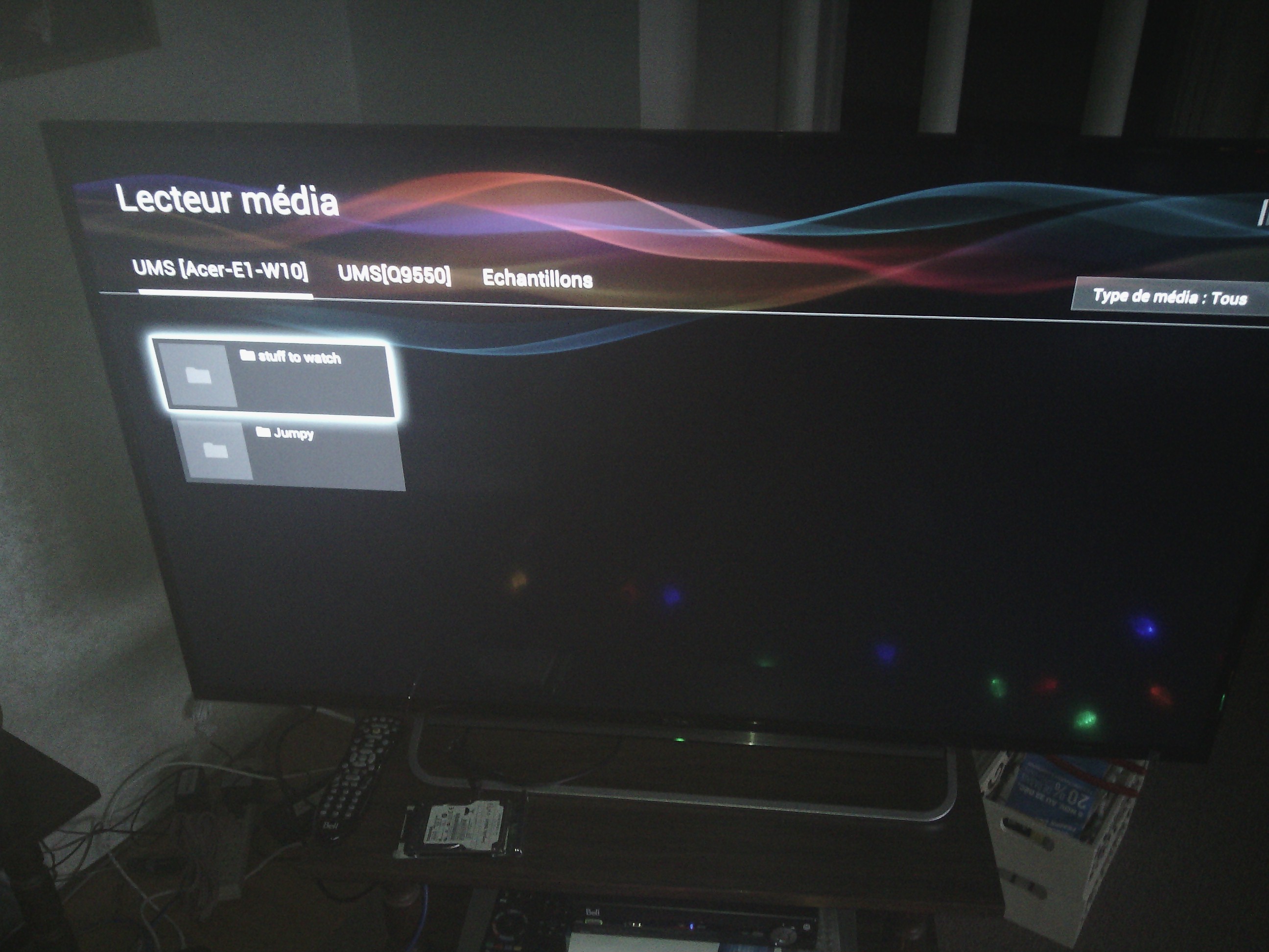

What are you talking about ? i believe its you that has misunderstood my question. i didn't say anything about a web browser or file system. You seem to think that the path i set is an URL for a browser ...
i've been using ums for years, i know what it is and what it isn't. I've even made my own config file for my tv and set up my own nases (plural) with shares to serve my home network.
Now, back to the topic which is making ums work with a folder on a >>>share<<< (eg: \\192...\tv\stuff, tv is a SHARE and stuff is a FOLDER in that share! not the Samba file system !)
Basically i want ums to show the files in that folder on that share on my network through DLNA when i launch my tv's media program instead of having to show the root of the share and navigate my way down to that folder (i hope i was clear enough geez!)
Just like it does to show the files in the root of a share, it would show the files in a folder when launching the media browser on my tv. i hope i was clear enough.
So that would mean ums would just load all the files from "\\192...\tv\stuff to watch" instead of just showing the root of that share on screen.
See what i mean in my screen shot ?
The network share is called TV and a subfolder is "Stuff to watch". i want ums to deliver to my television, the files in that folder, directly when i launch the player instead of just showing the root of the shared network drive.
Basically, i'd like UMS to "land" in that folder instead of the root of the share. (idk how many other ways i can explain to make sure its understood right by the reader.

I'm sorry that I misread your original backslashes for slashes, which was why I thought you were talking about an URL. I'm not used to seeing shares defined without name resolution, so that might have contributed.
In any case, I don't appreciate your attitude and I think your explanation is a bit hard to understand. To recap, this is my current understanding of your problem:
You have a share "\\host\foo"
You have a subfolder inside the shared folder "foo" called "bar"
You tell UMS to share folder "\\host\foo\bar"
When browse this shared folder from a renderer, the content of "foo" is displayed instead of the content of "bar"
If that is correct, it's not the intended behaviour. When I test this, I see the content of "bar".

I still haven't gotten a proper explanation to the problem, so I haven't been able to reproduce it. It's very hard to fix something you can't reproduce.
Re: Landing folder
Nadahar I think I understand what he means. He wants to send to the TV only content of the folder but it is the TV responsibility what is asking for. The standard behaviour is first ask for "Browse" and next for "Content". I think that what is HT1 asking for is against the UPnP/DLNA specifications.
