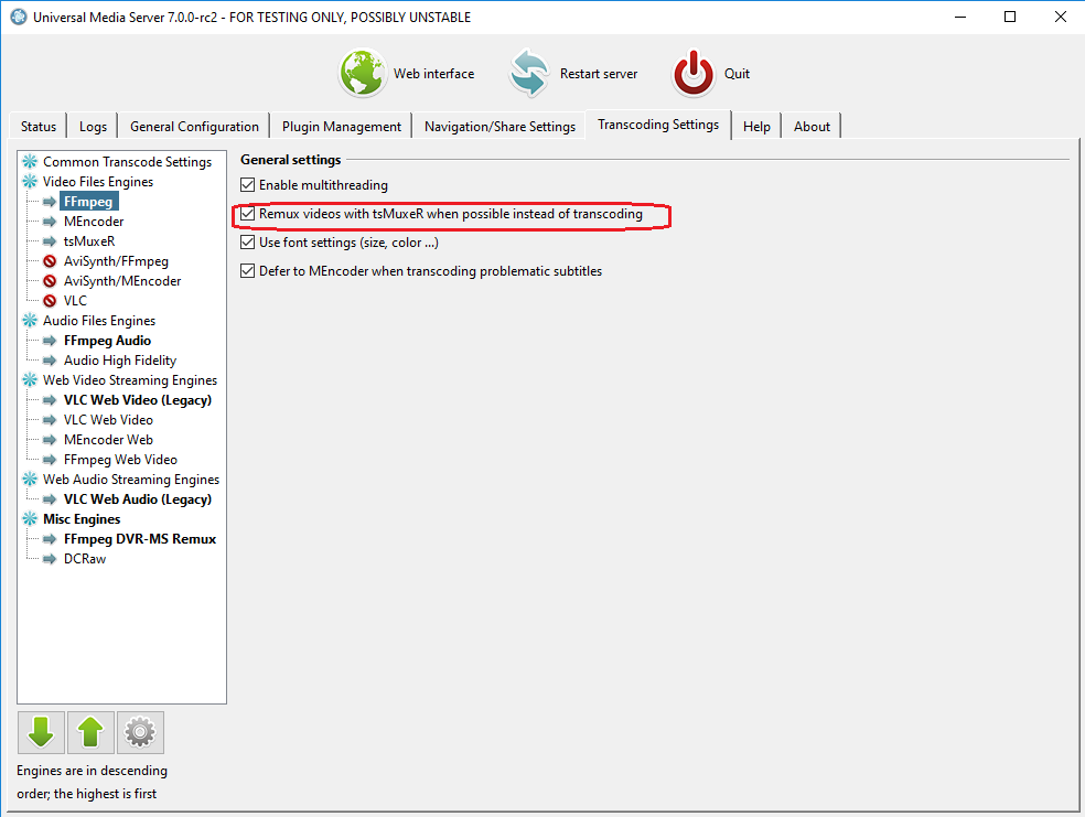

Guys have you tried to set FFmpeg as primary transcode engine and on its setting page set "Remux video with tsMuxeR when possible instead of transcoding"? It could copy video as it is and transcode audio to PCM format. Try it and send the log following the rules written in red above.

Re: How to Only Transcode audio and stream video without any transcoding to PS4?
Yes, but i thing that someting in renderer is not ok. In settings for ffmpeg and mencoder is checked remux when is possible. USM stream video and audio, but TV don't support DTS audio.

- settings.png (53.37 KiB) Viewed 13334 times
@Vick you are right that your Aquos.conf is wrong. First of all the UserAgentSearch should not be used and for recognition could be used only the and than you should set the UMS default renderer to "Unknown renderer" to let the UMS to recognise the renderer.
Second you should set to enable the setting of supported formats to let UMS to decide which format should be transcoded and which could be only muxed. Please do it, test it and send the log again.

With "unknown renderer" is working
Now i must to learn how to write exact *.conf to my TV. Thank You!
