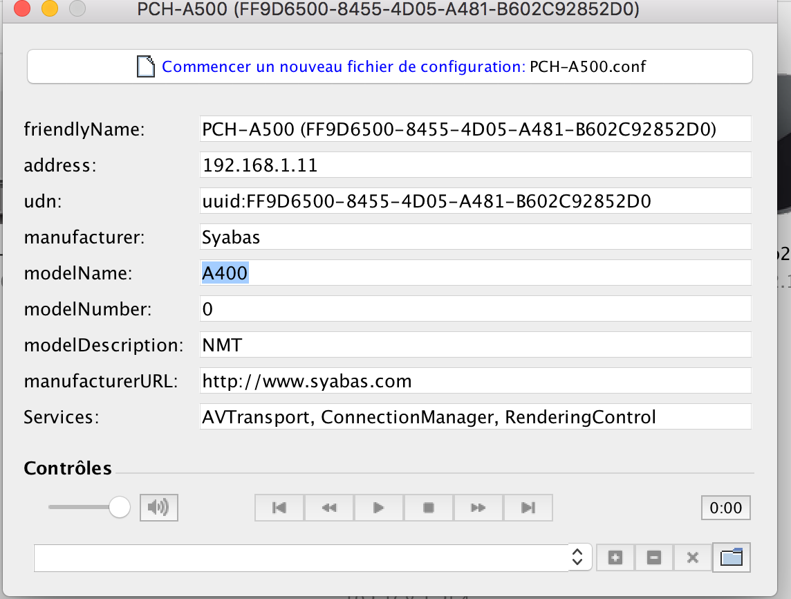

After rebooting the popcorn hour and restarting UMS, the popcorn hour is now visible in UMS.
So, I made some additional testing: removed the new PopcornHour A500.conf, restarted ums and it still sees the popcorn hour.
Tried to push a file from ums to popcorn, this works too.
The popcorn does not see UMS when browsing Network, but this is not a big deal.
Attahching logs and screenshot of pcha 500 being recognized.
Interesting to see the model recognized is a400 whereas the model is a500.
It seems that popcorn hour a500 is not doing a great job with network.
Thanks a lot for you help valib, I should have tried to reboot popcorn hour earlier.
Today I learnt.
Today I learnt.

The model name A400 is an internal manufacturer description but in fact the device name is the PCH-A500. I made a new conf for you and the image of this device which you can add to the folder "resources\images\clients". Can you test it?
